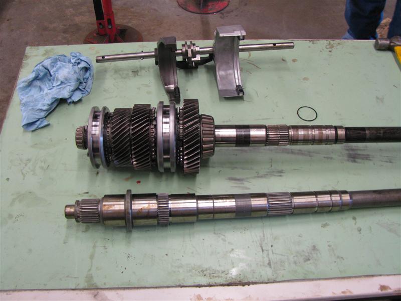

My $$$ is on the small tapered bearing on the left end of the top main output shaft shown below! It and the race in the input shaft are either rough or improperly shimmed!~!! That bearing is the only bearing in the whole transmission that is completely stopped in 4th Gear,thus "No Whine".:thumb
If there is a slight whine in 5-6 too,I'd be looking at the front input shaft bearing and race,and counter-shaft pre-load clearance (0.000-0.002 in) also.

The shop owner wants to try a different fluid that he's calling "Impact" by MTL. I did some googling and it looks like MTL is a Red Line brand, but there's nothing made by them by that name. He says it is a heavier oil that can even quiet a ZF. Anyone heard of this before? I'm concerned about doing damage to those paper blocker rings in the early T56's with any other fluid, plus I also feel like it's trying to cover up something that is wrong, like adding thick oil to an engine with rod knock. He doesn't seem to think it's a problem worthy of removing the trans to fix it, because he says his hearing's not so good and he can't hear anything and doesn't understand why I'm making a fuss about it.
Don't do it!~!!!! After carefully inspecting "ALL" bearings,races,main output shaft and the inside of the gear journals,I'm satisfied lack of lubrication caused my problem after about 25,000 miles,To the tune of about $2900. my cost for parts!~!!:hb
(But I did replace All torque tube bearings,bushings and installed a new LS7 clutch,pressure plate and flywheel while I was there!)
You'll end up with a bad case of "Blue Bearings" that a shot of penicillin won't help!~!!
:D
Blow up my photo 200% and look at the bearings and the 3 bearing rolling surfaces at the rear of the shaft,They've been Very,Very hot! :eyerole

I'm satisfied Royal Purple Syncro Max "Killed" mine!:thumb
(Thats what Royal Purple recommended for C5's on their website at the time!)
:ugh
I went back with Red Line D4 ATF only because I could get it and the Chevrolet Dealer parts guy in my hometown looked at me like I was nuts and didn't stock GM#88861800!
10,000 miles so far and All is well!!~!!
