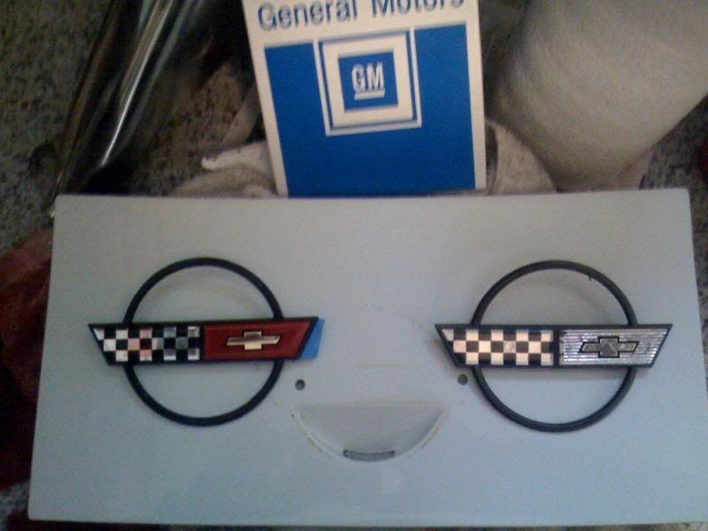

The new emblem I received didn't include the nuts, and since the plastic studs weren't threaded, it didn't occur to me that some little nuts might be needed. Nuts on there would definately
make them secure on the car, and be easy to remove when waxing(of course, if not taped)....oh well....too late for me now...mine are taped on and have no nuts on the backside(don't need 'em since the tape is super strong).
I was and still am, baffled that the new GM emblems I got from
tld were plastic and the original ones on my car were cast(heavy).
I didn't realize the diff till I had the first old one off, and I guess
an original 'cast' emblem wouldn't sell for $20 either.
The new ones do look nice!

Yes, the new ones I got from ltd were in a GM box, and are 100% plastic....and yes, they do look good, but I think they are a tad
smaller.....i.e. seems like the 'circle' around the emblem is thinner on the plastic....

I ordered mine from Mid-America Design and both are cast just like the originals on the car now (it's an 88). Funny that other companies have plastic. Nose emblem came in a Chevrolet box also but not the gas door one. This is my project for the weekend. I figure I'll probably need a handfull of nuts to put on the nose piece because my fat fingers won't work in the small holes they give you to work with.:hb
I think that the heavy cast emblems only were made for up to 1990. I wonder if the cheaper plactic ones fit and do they look exactly the same?
Well I replaced both emblems last night. Why is it that the simpliest things take the longest time?:hb
Used both a hairdryer and fishing line to finally get the emblem off the gas door (picked up these hints off this site). Took about 1/2 hour. Once off and cleaned up the new one goes on in about 30 seconds. Nose piece came off fairly easy but had a heck of a time getting the nuts back on (naturally dropping a couple down in the hood in the process).
Oh well, the emblems look great, it's going to be sunny and 65 here today and I drove the Vette. Going to be a great day!!:Steer
I changed them on my 91, the old ones were both metal and the new ones I got from GM were both plastic. I was a little ****ed that they switched them to plastic but once they were on they do look the same. I also did not remove the paper from the tape backing, I just used the bolts.
Putting the nuts on the hood emblem is easy. Just put the nut in the socket, wrap some electrical tape around the end of the socket so you just catch the nut then it won't fall off of the socket. After you get the nut on part way pull the socket off the nut, remove the tape and then tighten the rest of the way. I've take my emlem off the hood several times and haven't lost a nut yet.
