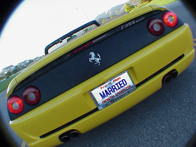

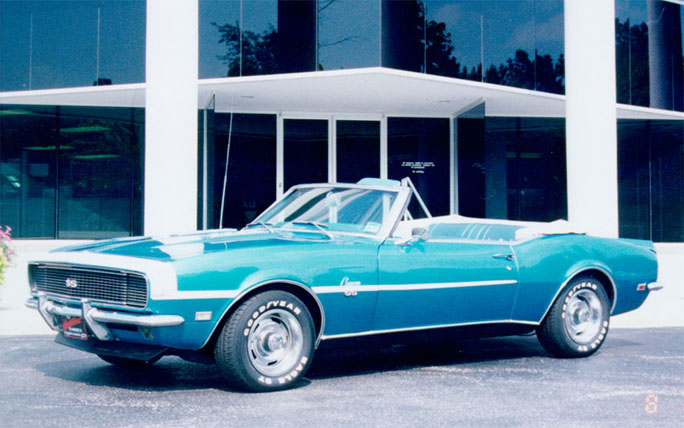

I also bought these on eBay..
Every one was great, no problems.
