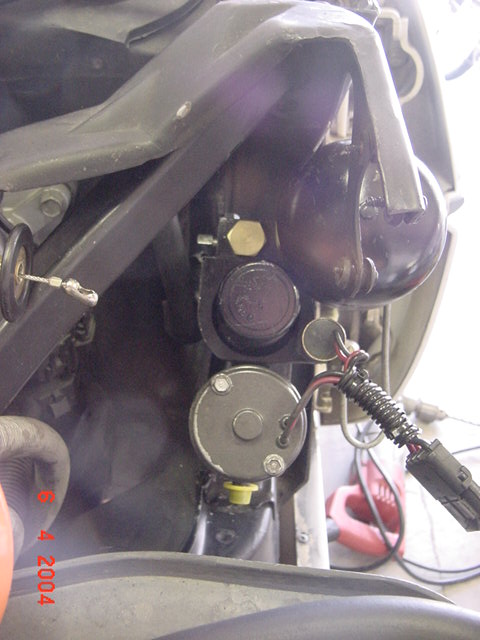

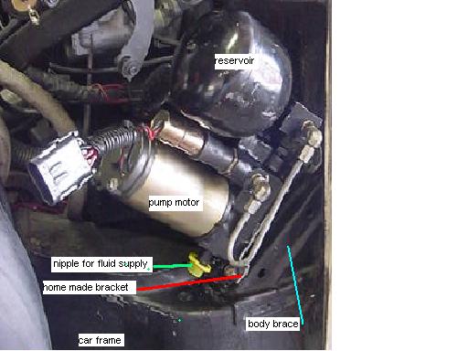

I am using an ABS http://www.abspowerbrake.com system, which has been redesigned (needed). Having moved my battery inside, it was natural to put the unit there, which also simplified the installation. Actually, I have mixed feelings about this system, but had few choices with 9" vacuum.
I was thinking more along the lines of tapping into the power steering system...like the early 90s Astro vans. That system worked great.
