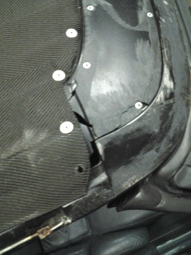

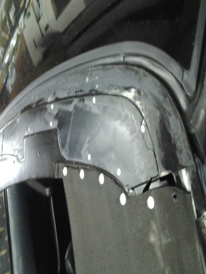

I'm replacing the top on my 91' Vert and noticed when I removed the fabric top, the plastic on the top of my front bow was cracked. Can this part be repaired or better yet, is it available and if so does anyone have a part#? Attached pics of one side, but other side is cracked, also.:ohnoes

I would mix up some JB Weld in a Altoids Tin...heat it with a hair drier slightly and it will turn to a self leveling liquid. Apply to the crack to fill and let it harden then sand or file if needed.
