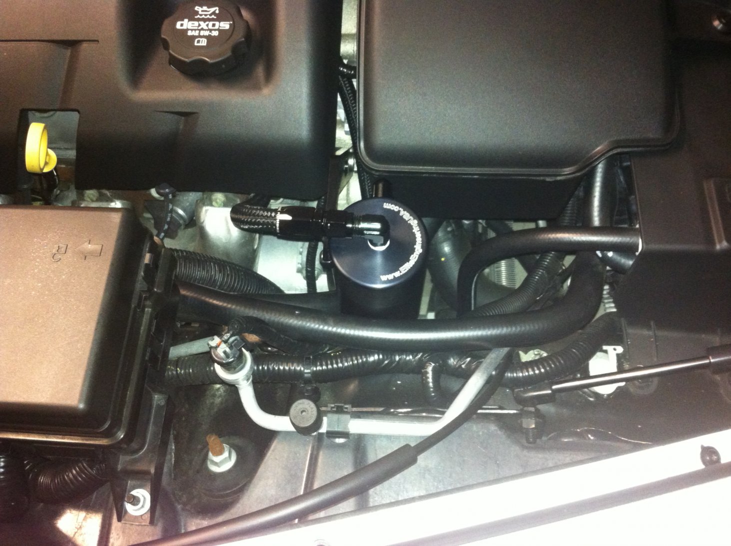

Installed an Elite Engineering Catch Can on my 2013 G/S. Will see how effective these things are.

What problem are you trying to fix with it?
More like preventative maintenance option for your PVC system. Helps keep unwanted oil and other vapors force back through your intake, which should help keep valves clean.

If you'r worried about keeping the backside of the intake valves clean, use a detergent based injector cleaner like Chevron Techron on a regular basis, say once every 4 or 5 fill ups.
Unless your a serious trackday persion, my guess is you won't find a lot of oil in that catchcan system.
About the only sitaution where a catchcan is useful is in cases of racing duty cycles where you get a lot of flow reversal though the PVC, ie: you get oil vapor coming out the clean side into the TB.

I installed the Elite catch can in my 2014 non Z51 coupe. After 3000+ miles, I had collected almost 2 ounces of oil. Of course with a direct injection system, I wanted to catch as much oil from entering the system as possible. Not all catch cans are the same and I found the Elite to be very efficient as there was no oil in the outlet line from the can. The Z51 package requires another hose installation on the wet side. Chevrolet is on record I believe that catch cans are not necessary on direct injection engines, but the installation does not void the warranty. To solve the wet (dirty) side of the system on the Z51, Chevrolet recommends that the oil level on the dip stick be at the 1/2 full mark or less, oitherwise the air filter box gets coated with oil. Many European manufacturers install catch cans on their direct injection engines. I have not put a catch can on my 2008 connvertible.

The OP was about catch cans on port injected engines. I think they are a waste of money and effor unless the application is a track or race car.
Oil ingestion and catch cans on DGI engines is a different issue. All manufacturings with DGI engines are having to deal with what to do about intake valves which get oiled through the normal function of the PCV system and then the oil cokes.
My understanding is that right now, if it's forced to address an DGI engine with coked-up intake valves, GM replaces the heads.

I honestly don't know if it is a problem for N/A or boosted engines; however, I'd prefer sending the oil vapors into a can rather than into the intake manifold. Not all the oil vapor makes it to the combustion chamber; some stays as deposits in the intake manifold.
As I am boosted; I plan on venting the driver's side valve cover to the can also. Pressurizing the crankcase creates a resistance as the pistons come down. Under boost or high RPM operation the PVC's job is to prevent pressurizing the crankcase.
