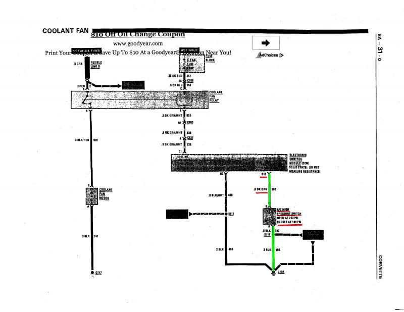

Take a piece of wire and ground the Dark Green wire
to the negative battery terminal. It's possible if you
removed any of the wire harness the Black wire is
no longer grounded. The Dark Green wire goes to
pin D11 of the ECM.
The ECM also uses the engine coolant temperature
sensor mounted in the front of the intake manifold to
turn the fan on when the temperature reaches around
228F.

C60 manual, cooling fan behind radiator, engine needs to be started, no manual fan switch, worked perfect before i took out the a/c, all wires at fan relay look ok, i haven't been doing anything around this area.
Any ideas?
Thanks
If you plugged the 3 connectors back in and the fan
still comes on that makes no sense.
It could be the Dark Green wire is not making connection with pin D11 of the ECM.
You could strip some of the insulation off of the Dark
Green wire and connect a wire to it and the negative
battery terminal and see if that works.
Other wise you need to ohm out the Dark Green
wire to the ECM connector pin D11. There must
be a break in the connection.

The schematics show 3 connectors.
1) High pressure cut out switch is two Black wires.
Switch opens when AC pressure reaches 430psi.
2) Low pressure cycling switch (evaporator tube)
DarkGreen/White wire and a Black wire.
3) High pressure fan switch. (for some unknown reason
the manual shows it as high pressure switch). Other
manuals call it a fan switch. Switch opens at 233 psi
and closes when pressure is below 180 psi. When the switch is closed a ground is placed on pin D11 of the ECM. When
the switch opens the ECM responds by turning on the radiator fan. The connector wires are Dark Green wire and a Black wire.
This is the switch that must be causing the fan to come on.
The only thing I can think of is the connector pin for the
Dark Green wire is damaged inside the connector plug.
So I recommend you use a razor blade and cut back
some of the wire insulation from the Dark Green wire a
couple of inches in back of the connector plug wire.
Then attach another wire to the exposed wire and the other end to the negative battery terminal.
