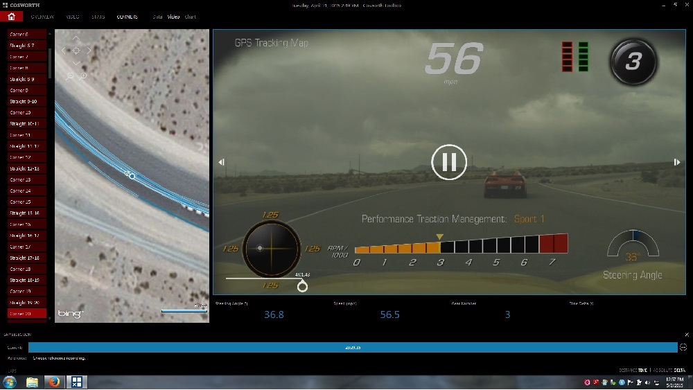

Cosworth designed the Corvette Performance Data Recorder and they have a free software package that will give a very good view of your driving sessions. The attached screen dump is from my sessions at Ron Fellows. The map overlay is based upon PDR GPS data and the video is from the PDR camera. You can use two passes on the same track to compare performance so I used the insrtructor lap as the standard and compared each solo lap of mine to see how I was doing. By the end of day two I was approaching the same line, turn-in points and braking points as my instructor. This toolset will really help you evaluate your progress if you use the recorder for your track sessions. It is free from Cosworth at this URL: Cosworth.com | Cosworth Toolbox for Chevrolet Corvette
