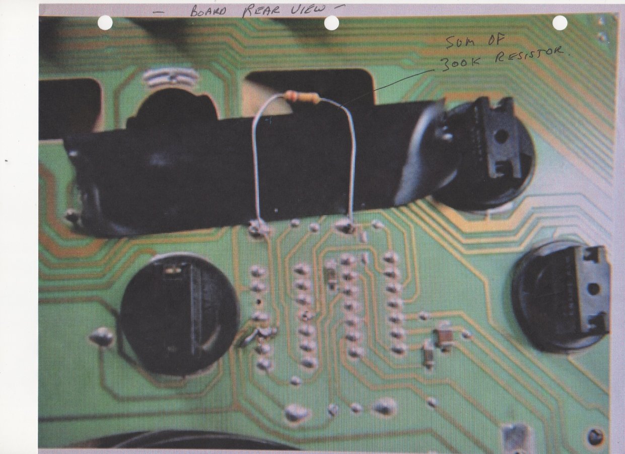

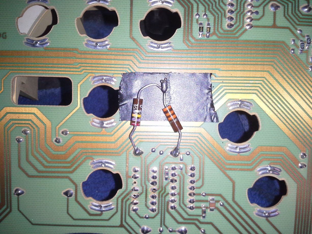

You have to fix the circuit board behind the tach. Search for tach repair. There should be a bunch of articles here on it. I just cant find mine right now. You have to dis assemble the dash cluster and remove the circuit board. I then took mine to my local TV repair guy and he bypassed the bad resistors and soldered in new resistors. Now the tach is accurate as can be. Check my next post here for photos and instructions. It'll take me a bit to dig up the info.

Here are mine I kept as a record. Note: Be sure replacement resistor(s) total 300k or very close to it. The second picture is my arrangement. Worked like a charm.
