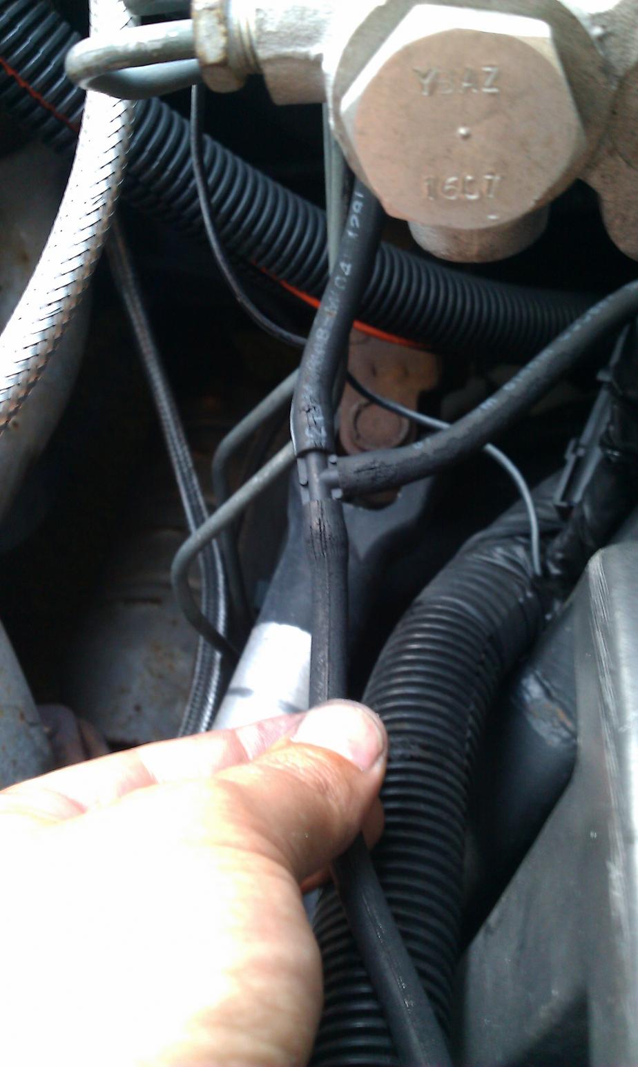

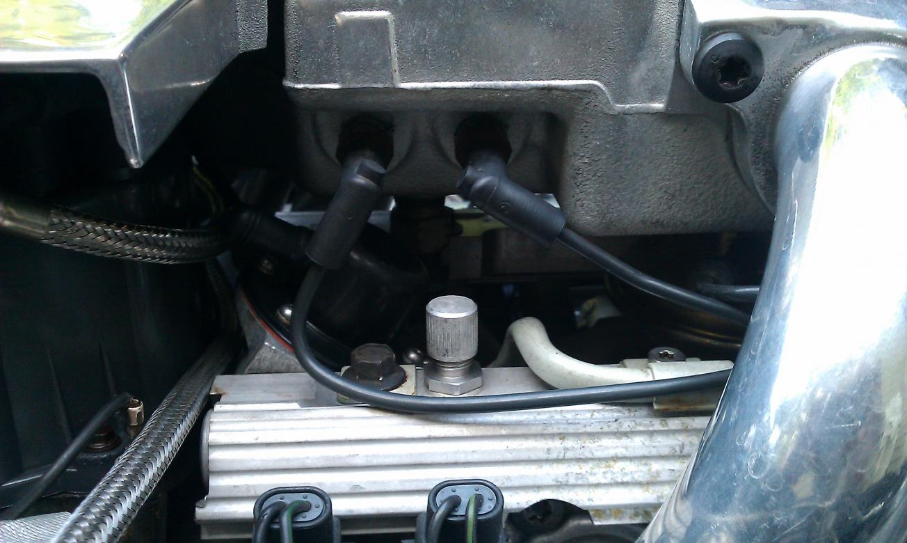

Having close to same issue please help!
Had my heads redid and just noticed my mechanic didn't put back together two vacuum lines. One, "looks" like it was disconnected from the fuel pressure regulator to the black plastic T next to the distributor which split the tube running from firewall to cruise control and vacuum tank at left front headlight. I seriously hope that is where the connection was supposed to go. Also, another line from the side of the plenum going up under the bottom of the throttle body. I reconnected them and everything ok. Idle even seemed to be better.
My problem started originally with the AC not blowing air very well. After doing testing on the variations in speed for the blower, getting cold air and hot, everything seems fine except the air not blowing hard. So after reading more it seems that a vent flap door could be stuck in the dash. So later reading found that it runs by vacuum along with the cruise control. When running the ac, heater or defrost all the air blows out of the top dash, front and floor the same no matter what you have it on, ac, heat or defrost. So now it seems that I have a vacuum problem that isn't making the AC blow hard right through the front vents, or heater to the floor and defrost to the windshield.
I have started the car and detached all lines from the T that splits off to firewall, fuel pressure regulator(I hope), and off to CC and vacuum tank to see if I was getting any vacuum whatsoever and I do not. I would imaging I am supposed to be getting a suction of air from the tube coming out of the firewall and do not.
This is where I need help on where to go next! I have read that this tube goes into the passenger side around the ECM which then goes to a module that controls the flap above the gas pedal. have not gone this far yet. really trying to find out where the original source of the vacuum is located so I can run it down from there.
Any thoughts?
Any thoughts?
Sounds like your vac lines are ALL screwed up...
Lets start fresh..
2 ports at the rear of plenum....1 fitting goes to the front of eng to the air diverter solenoid and switching valve.
2nd line splits to fuel regulator and to distributer area where a check valve T splits to the firewall line for inside the cabin other side goes to cruise control and has another T on wheel well area driver side....to cruise and to vac can.
Underside throttle body goes to a T where EGR solenoid is one side and the emissions purge is on other. This is 'ported' vac and MUST be connected to the things that I listed in the way that the tag shows on the fan shroud, as described.
Get all that straightened out before diving into the dash area where you most likely DO NOT want to mess with anything.......
BTW...don't mess with the vac programmer (above the gas pedal) until you can prove that it might be faulty. You'll only make things worse by taking that thing apart. Those rarely fail. They have, but its very rare.
Hope this helps
Ok from what you are saying I know there are two vac ports at back passenger side of plenum. Both vac runs in the picture go into a 2 into 1 splitter just right off the end of the picture behind the second intake runner which then goes to the front of eng to the air diverter solenoid and switching valve at front of engine. Why it is setup 2 into 1 tube I have no idea. But the way it is run seems to be original but of course I could be wrong.
I have a feeling one of these should be split, like you said, to fuel regulator and to distributer area where a check valve T splits to the firewall line for inside the cabin other side goes to cruise control and has another T on wheel well area driver side....to cruise and to vac can.

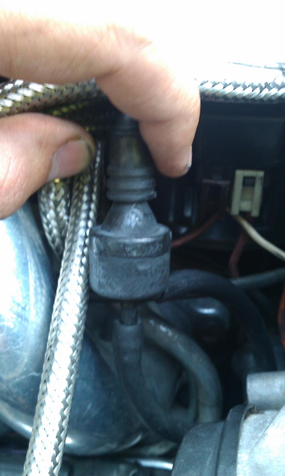

In this next picture is the check valve, the top that I am holding is going to the fuel regulator which I believe is wrong, the other two are correct going into the firewall and down to the other T for vac can and Cruise Control. If the top of the check valve is going to the fuel regulator only, that would explain why I am not getting any vacuum from one of the plenum ports. But why would there be a two into 1 on the others that completely looks like a stock splitter?
The EGR goes to a port directly under the throttle body. Yeah I think my mechanic might have messed some things up. I am not a mechanic but i am not stupid to it either. That is why I am trying to fix this myself. Any other thoughts or questions to help?

The vacuum valve in your picture should be installed with the large end getting vacuum directly from the manifold with a piece of vacuum hose to connect it to the manifold. The cruse vacuum comes off the straight nipple and the ac comes off the other nipple. The fuel regulator should have a direct uninterrupted line from the manifold
I believe I got it now. Air blowing hard now. After listening to you and looking at the diagram on the fan shroud, I made a direct line from top end of check valve directly to manifold rear vac plug which now gives vacuum to CC, tank and firewall. The old connection I had disconnected for that now got connected directly to the fuel regulator. I also corrected the other (front manifold) vac to the front drivers side right plug whatever that is and the left side of that is then split into the under throttle body and other tank very front under headlight. Directly as diagram says. AIR blows 3 times harder through vents and idles well too! Now on to the cruise control cause that isn't working. have a feeling its the diaphragm. Will check tomorrow. Didnt work that well 6 months ago but will check the vac there as well! Thanks so much!
