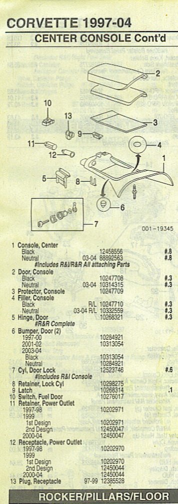

According to my Mitchell Crash Manuel,97-2004 Black are the same part #!!~~!:thumb
In 2003 and 2004 there was also a Neutral Color offered and it's a different part #,But I'd guess it's the same except for the color!:thumb:thumb

10276017 is the correct and only GM# 97-2004 Corvette Fuel Door Switch
There are 2 designs of power outlets though!

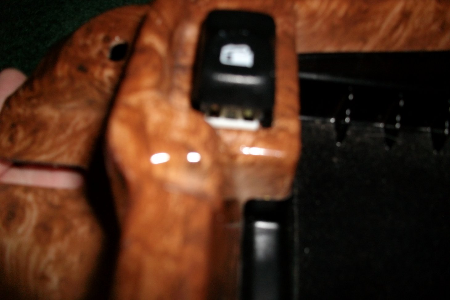

I have always followed your advice and I consider you the expert next to Junkman2008. But gentlemen, there is no way to install the gas door switch into the 1997 console. I bought another 2003 shale colored rear console from Vettenuts Inc. and when you place the 1997 next to the 2003, you can see their the same exterior size, but the extra power outlet WILL NOT go in the hole as well as the gas door release WILL NOT FIT. There's no adapter or any kind of plastic do dad the will allow a switch to fit in the 2003 console. Like wise the 2003 gas door switch WILL NOT fit into the 1997 console. I know you guys are thinking this idiot just doesn't know what he's got, but I clearly understand that a official parts manual says there is no difference, but there is. As soon as the 2003 comes back from Texas I'll put them down on the carpet and take photographs so you can see for yourself. But the 1997 console does have a plastic adapter for it's switch, but the 2003 has no adapter at all, the switch snaps into place on it's own as does the extra power outlet, you simple push the power outlet into the hole and twist it a half a turn for it to lock into place. There's no adapters or anything that makes the switches adaptable to the 2003 console, they go into each respected holes/slots and they work right just as they come out of the GM parts boxes.
I believe you man, just post those pics as soon as you can. You can teach us all something!
The difference in years,

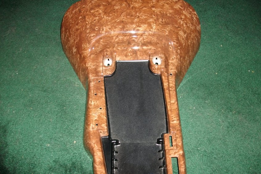

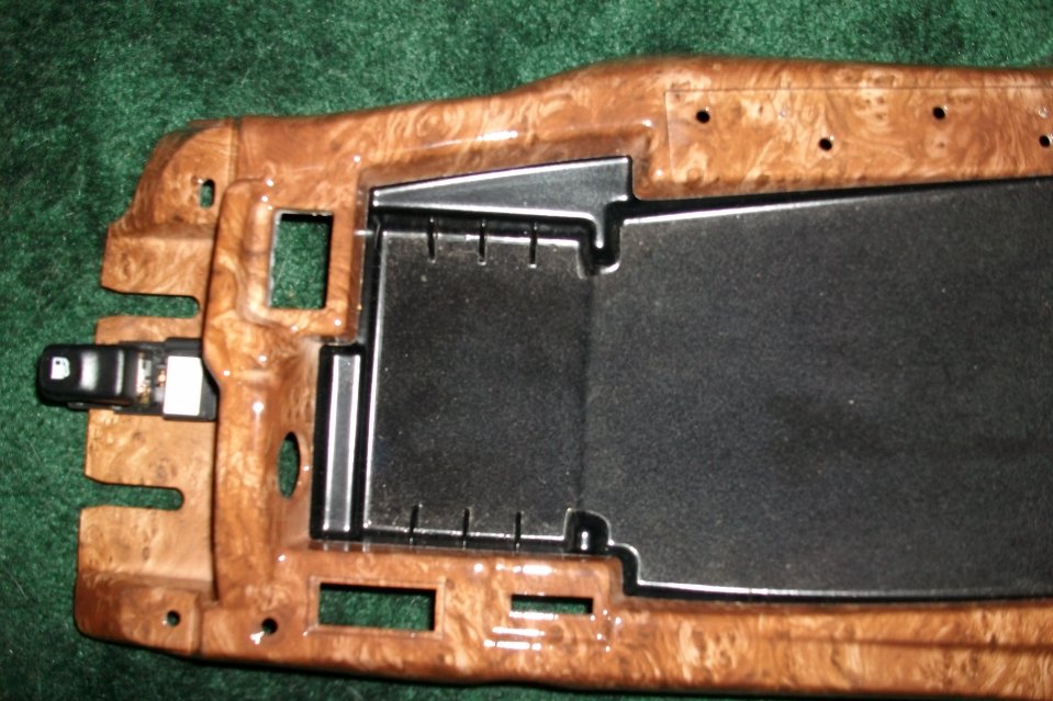

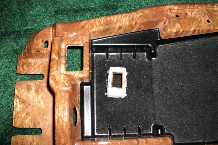

You can bet on it. But you'll see the 97 console has a switch that snaps into an adapter, and it snaps into the console. On the 2003 the gas door switch snaps into the console alone. It can only go in one way. I'll post pic's. :w

I've had the console on my living room floor all morning, and I think I have the answer, The consoles are all the same, with two exceptions, One, the gas door switch is totally different in a 1997 from 2003, and the switch itself fits into an adapter and the adapter fits into the console, Now two, the Power outlet is a tad smaller or, the later models took a slightly smaller switch/outlet. So I correct myself, I was wrong and you were quite right ! :w

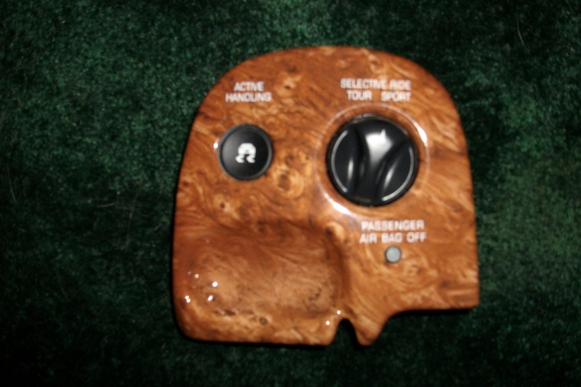

OH boy, you went with the dark burl-wood, I picked the medium burl-wood and I did my rear console, the front trim switch panel and the door handle surrounds. Lots of people say "Why didn't you go for Carbon fiber?" First off Carbon fiber looks sort of out of place in an automobile, and a "touch" of the burl wood give the interior a nice soft feel. I changed the shift boot and the emergency handle boot as well and the company I use even re-wraped my A4 shifter knob. Anyway that just me, but yours is just short of beautiful !
