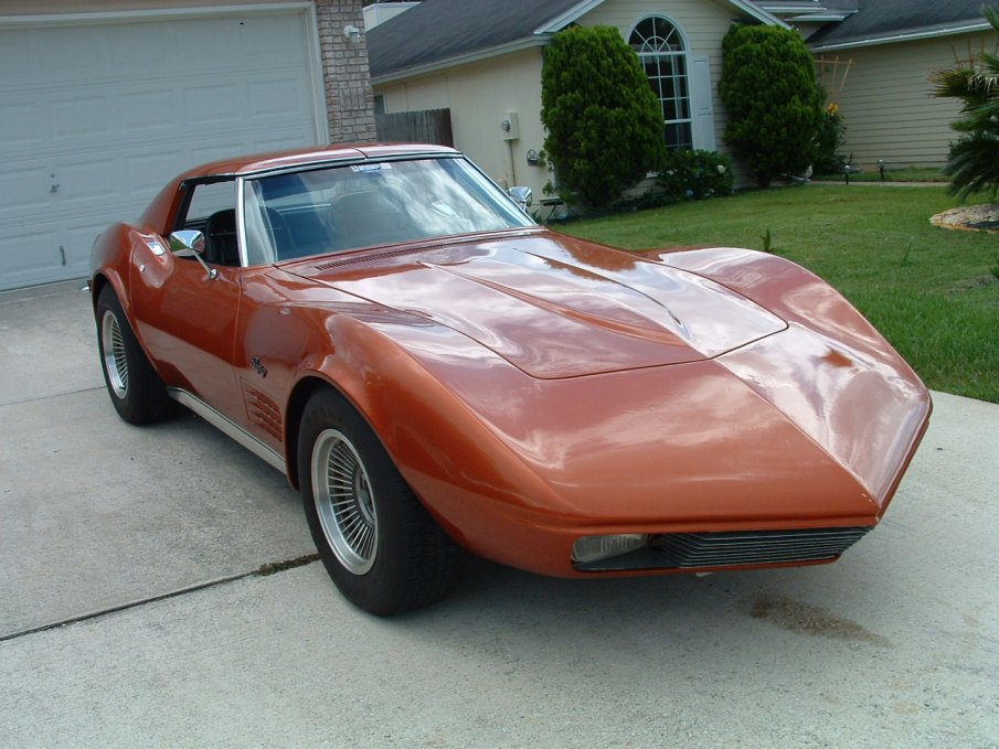

I own a 1972 C3 (Shark-Nose) Stingray and I want to update my wheels. I put a C4 ZR1 upto the hub and they look nice but there is a clearance issue with the steering. Or does anyone know where to get ZR1 style wheels for a C3? I would like to go with either a 17" or 18" all the way around.

Shark nose
Shark nose is a custom front end that takes the lights out of the top of the nose (like the Mako) and puts them where the grille is then it's all fiberglassed in.

What is a "Shark Nose"?
OUCH! - sorry, don't mean to offend anyone - I believe in keeping things as original when it comes to the older cars.
