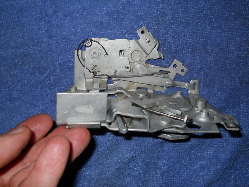

In the door repair kit they have 4 springs for the 63-66 models and 6 springs for the 67 (3 for each door mechanism). The extra ones are very small circle springs (maybe 1/2" circle) with very short attaching tabs/hooks. Anyone able to tell me (or better show me) where this extra spring goes? I cannot figure out where this might go. Thanks. Hal

The extra circular spring for the '67 door latch is for the '67-only "free-wheeling" feature; you can see it in the upper left corner of the photo below.

John, in the upper left is the spring with long "legs" which supports the lock mechanism. I can't see it for sure but are you indicating that the smaller spring with "short legs" is behind the other spring? That black line? Or, did I miss your point?

I'm referring to the circular black spring at the upper left corner of the photo I posted above; it's actually double-wound, with a smaller circle in the middle of the larger circle, that fits over a tang on the mechanism to retain it. Photo below shows the same latch from a different angle which may help explain it.
John, I'm not sure I yet see what you refer to so I copied your photo and circled what "I think" you are pointing at.
The large spring is circled in purple. The medium spring is circled in red. Those two I understand and have in the correct locations.
Is the small spring what I circled in yellow? I sort of see one "leg". If not, am I getting close? Sorry for all this but I do want to get it right. Thanks. Hal
Looks like you have it surrounded - I don't have a '67 latch handy outside of a car to examine; the location of the small yellow-circled spring on my '67 is blocked by the rear glass run channel, so I can't see it except in the photos I posted.
