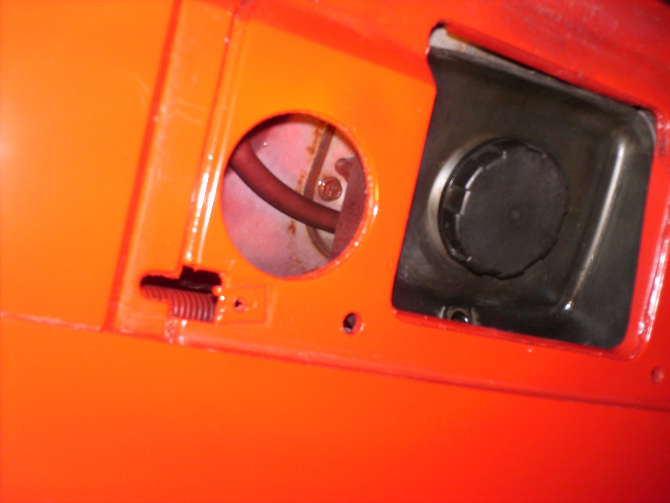

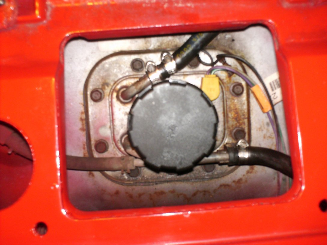

I loosened the lines, and it started flowing good.
If I dis-connect the line in the pic, will the flow stop from the tank?

just pull fuel pump fuse and run car till it dies then should be just minor fuel draining. But if you are disconnecting lines you will have to disconnect the line that is at the front of the sending unit that faces the passenger side of the car. That is the feed line.

Yeah - I gotta' unplug, and it started flowing FAST. Not from pump pressure either, but just from FULL tank... Half a gallon (plus) spilled makes me nervous.
So the line shown in the pic, toward the driver's side, is NOT the feed line? Must be return then???
Thanks!
that is a vent line
this is how pump looks, if you are looking at it from drivers side. top line facing passenger side is feed, bottom line facing passenger side return, line facing drivers side is vent.
Feed + return is on passenger side of motor too. :duh AND, Charcoal cannister / EVAP is on driver's side, up front. :duh :duh :duh
My '87 didn't have this excess flow problem for fuel filter change, that I remember... ;shrug
So the rubber gasket around the filler neck lifts OVER the neck? Mine is TIGHT. Will it tear? I know of no other place to dis-connect the feed line...
Pulling the FP fuse won't help one bit!~!!:thumb
If the fuel level in the tank is higher than the filter,The fuel will flow till the tank is near empty! (less than 1/4 tank on a C4)

Found this out the hard way. I was fast with the pan, even faster getting the filler door lid off and rubber boot. Saw the rubber lines, hose pinch off pliers saved the day. This is how I do them now.
Just pinch of the feed line/return line and all will be well.
Hi Jessie...
I got the front end up about 18" right now, and you're right about FAST - I had the filter loose, and fuel was comin' STRONG!
I'm lookin' at dis-connecting the lines at the filler neck, to limit spillage here...
edit:
got both lines un-hooked, and then got the filter off with a minimum of spillage...
