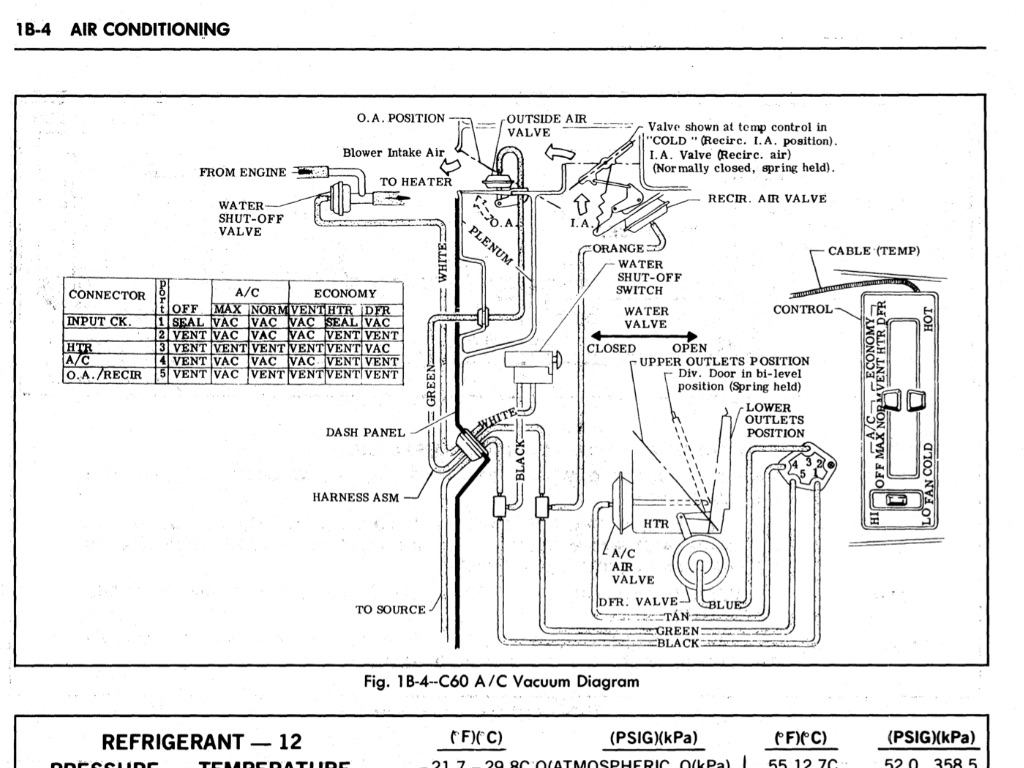

On a 79 L82 and anyone tell me how the vacuum lines are routed from a vacuum source...........I have 4 vacuum lines at the heater/ac vacuum control switch. One goes to the lower vent and another is routed thru the firewall to the upper vent. The other 2 I'm not sure where they go unless I tear the dash out and trace them down(don't want to do that unless I need to). Also on the hearter/ac control vacuum control switch I have one port the doesn't have a vacuum line connected to it (should it have one any where does it go to......

Have attached the diagram from my 81 FSM. Should be the same for a 79.
There should be a port with nothing on it, so no problem there.
