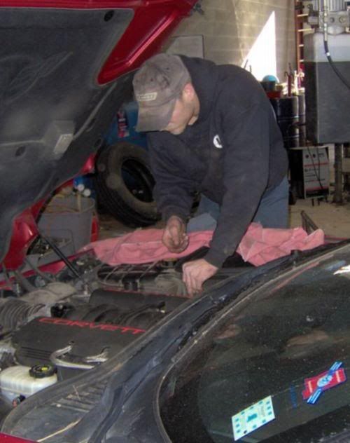

Finally got my Corvette in the shop yesterday and Chris changed the oil pressure sensor. It's scary watching someone take the top off the motor of your baby! :ugh
He also changed the tire pressure sensor that went out, did an oil and filter change and replaced the coolant and intake gaskets.
Oil pressure on the way home was 32 psi ! Beautiful!
Thanks Chris!
:w Jane Ann

I'm really fortunate to have a great team taking care of my baby! :upthumbs
Kevin (manager) and Chris (MY exclusive mechanic thank you very much!) are great guys who know a lot about Corvettes and will sit down at the computer to search their resources if they run up against something unfamiliar. In fact, along with the CAC they're my best Corvette resources.
They're careful and conscientious in their work and they don't mind me observing and asking questions. I think this is a courtesy they extend to only a few because I never see anyone else in the shop with the mechanics.
And it helps that they know how I feel about my Corvette and would go off like a bottle rocket if they hurt her! :D
