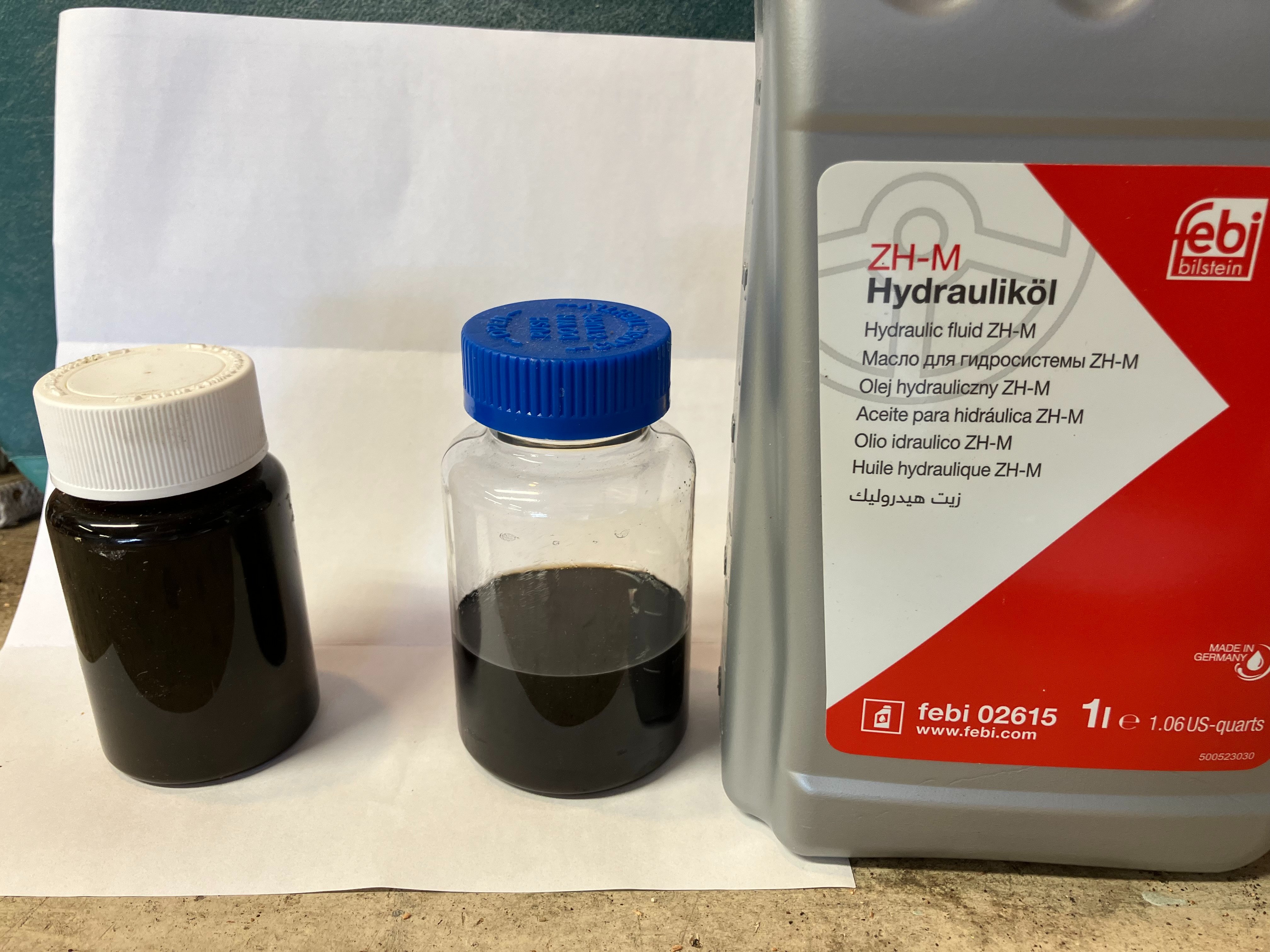

Here's a pic of the fluid I pulled out of the rez. And the fluid I replaced it with.
It looks about the same.
Sorry, those 2 bottles are the same fluid. I had too much to fit in 1 bottle, so I used a 2nd bottle. This was about 35cc's of oil. (Mobil oil is factory fill.)
Refilled almost 100 cc's of the oil contents of the 1 liter bottle on the right.
Sorry for the confusion.

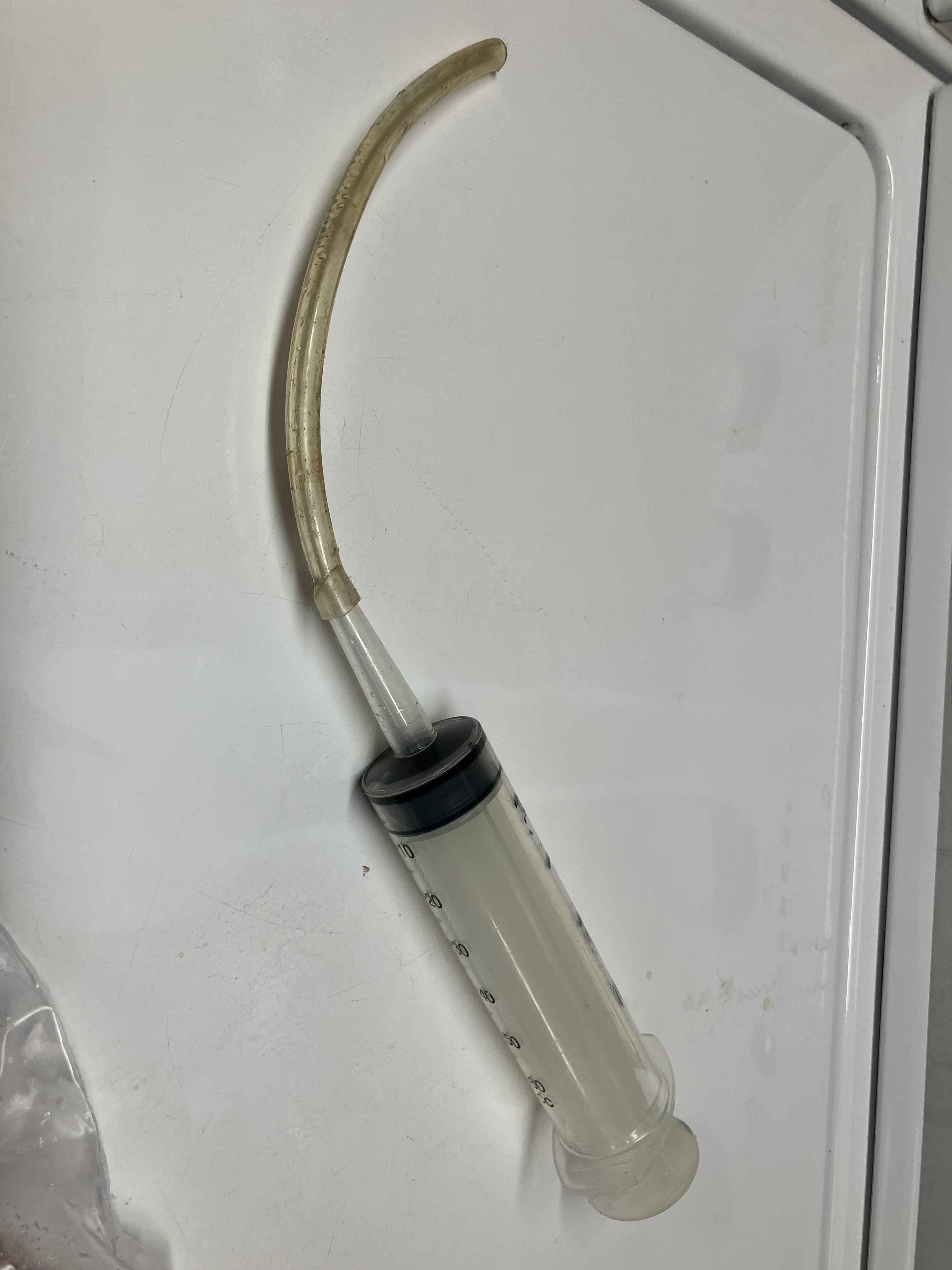

I used this to pull the fluid out of the reservoir, then inject clean fluid (about 90 cc's.) into the reservoir. Worked too easily.
Is that a feeder for giving cats medicine?

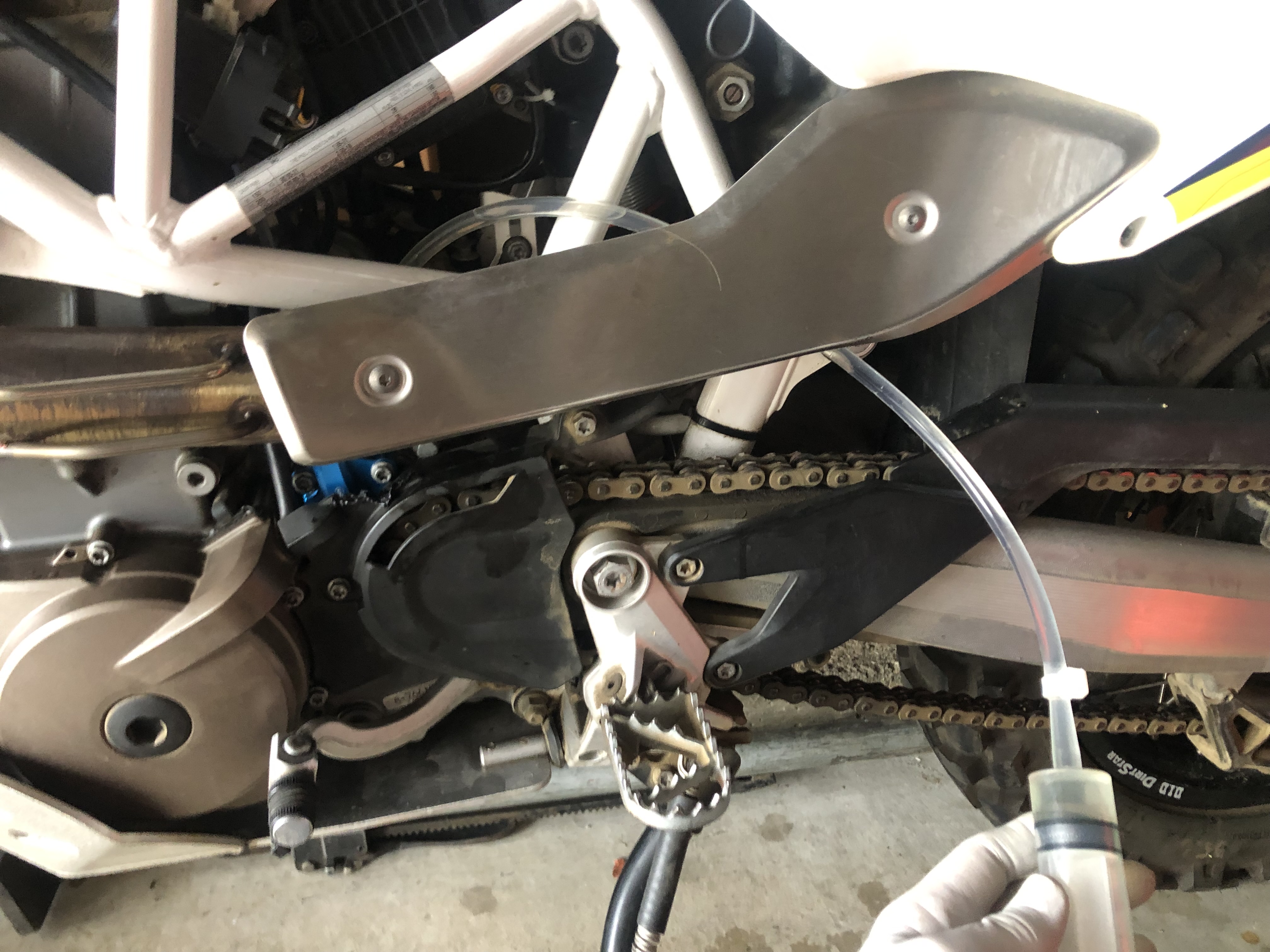

I suppose it could be used as such. Actually, the syringe IS from an equine supply. And the clear vinyl tubing is general use aquarium air line. I use these for many purposes. I have dedicated syringes for:
injecting brake fluid into the bleeder of brake calipers. This forces fluid up into the M/C. Zero trapped air!
Pulling the excess fork fluid out of the top of the tube, precisely. (For motorcycle use.)
and tons of other uses.
Here, I'm using the same syringe to inject hyd fluid into a clutch slave, then up into the M/C on my Husqvarna 701...
