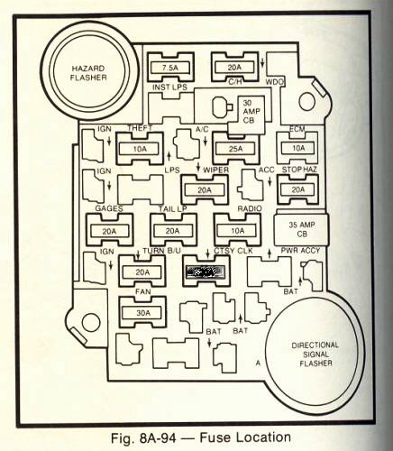

Google '81 corvette fuse box' under images, lots of pictures come up, you might be able to get some idea from there.
I don't know if this will help, here is a copy of the 1981 Fuse Panel ;)

There's three largish orange wires there. Does this one have 12v on it? (With ignition on)
I'm guessing there isn't. In which case it's come out of the fuse marked "ctsy clk"

If memory serves me correctly there can be a large 12 gauge wire that feed the high blower relay. I would plug it into one of the "batt" labeled sockets on the fuse panel which is 12v all the time and see what does work. If a circuit starts working that should not be with the key off (basically any accessories that only work with the key in run or accy's) then install the wire on an "ign" terminal on the fuse panel and see what works with the key on. I would also check for parasitic drain at the battery after performing the operations. Good luck with it. :)

Its not part of the capacitor that goes in parallel with one of the fuses. Maybe radio fuse?

Just checked on mine. I can only see one orange wire that it might be (the others just seem too hard to knock out accidentally)
It's for the key warning buzzer. This is on the same circuit I mentioned above. So if this wire was to come into contact with ground it would blow that fuse.

So I also have one (thin) orange wire for the buzzer but also a thick orange wire I think it's connected to the BATT connector.
