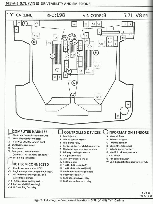

The fuel pump relay is inside the engine bay next to the vacuum brake booster as shown in the attached diagram. (This is from my 1989 service manual, but it's the same for your 1985.)

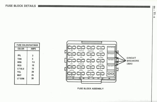

The windows and mirrors don't have relays per se, but their fuses are located in the fuse block located in the dash end panel on the passenger side.

thanks i did see that and someone replaced the fuel pump relay, but still no power ,i see 2 small relays near the pump as well maybe one is the hatch ,it does work the window motors work with power to them directly but not through the switches,and the door locks work i switched the door and window relays, the locks work with either relay ,so they are both good no power to the mirrors though also i read about the cold start fuse so i need to check it now i hat electrical problems
