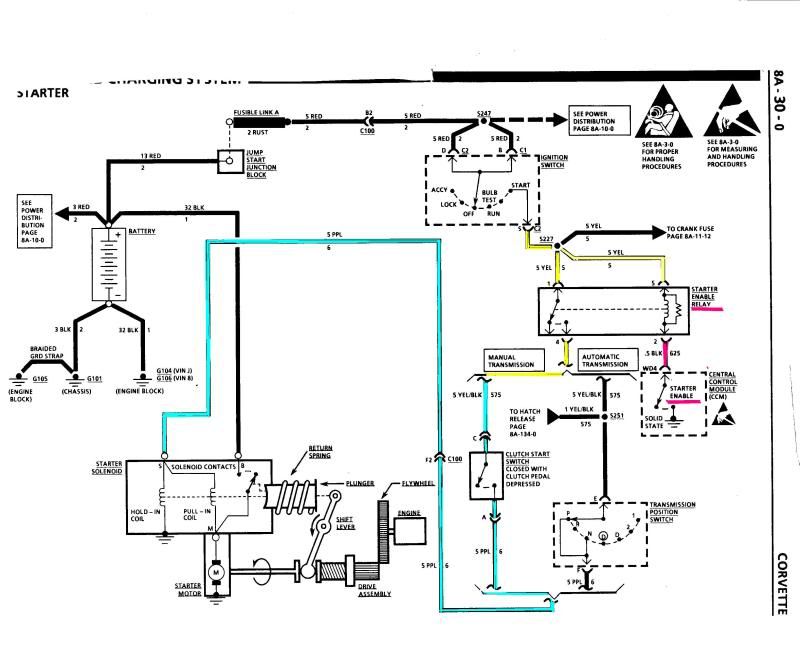

The starter circuit is very simple.
When you turn the ignition On if the key pellet matches what the CCM was programmed for it grounds the Starter Enable Relay.
When you turn the key to Start.
The relay closes. 12 volts from a Yellow wire from the
ignition switch passes thru the relay and out of the relay via a Yellow/Black wire. The 12 volts then passes thru the Clutch Safety switch if closed and out of the switch via a Purple wire which goes to a push on lug on the Starter Solenoid.
If you have to engage the clutch pedal to start the car there must be a Clutch Safety switch some where around the clutch linkage. In the US cars the two wires at the Clutch Safety switch are a Yellow/Black wire and a Purple wire.
The most common problem is the Clutch Safety switch can't handle the current the Starter Solenoid draws which causes the switch contacts to pit. In the latter model C4's the Clutch Safety switch was moved to the primary coil side of the Starter Enable relay.
The Starter Enable relay location is identified in the diagram I posted. It could be in a different physical position because the relays are mounted on a slide on mounting bar so the relays themselves can be moved around on the bar. To identify the correct relay you need to look at the relay socket wiring. There should be two yellow wires, a Black wire, and a Yellow/Black wire.
To gain access to the relays you need to remove the panel holding the footwell lamp, remove the carpeted panel and then the metal panel below the steering column.
The relays in that location are all the same so you can swap them around if you think the relay is bad.
