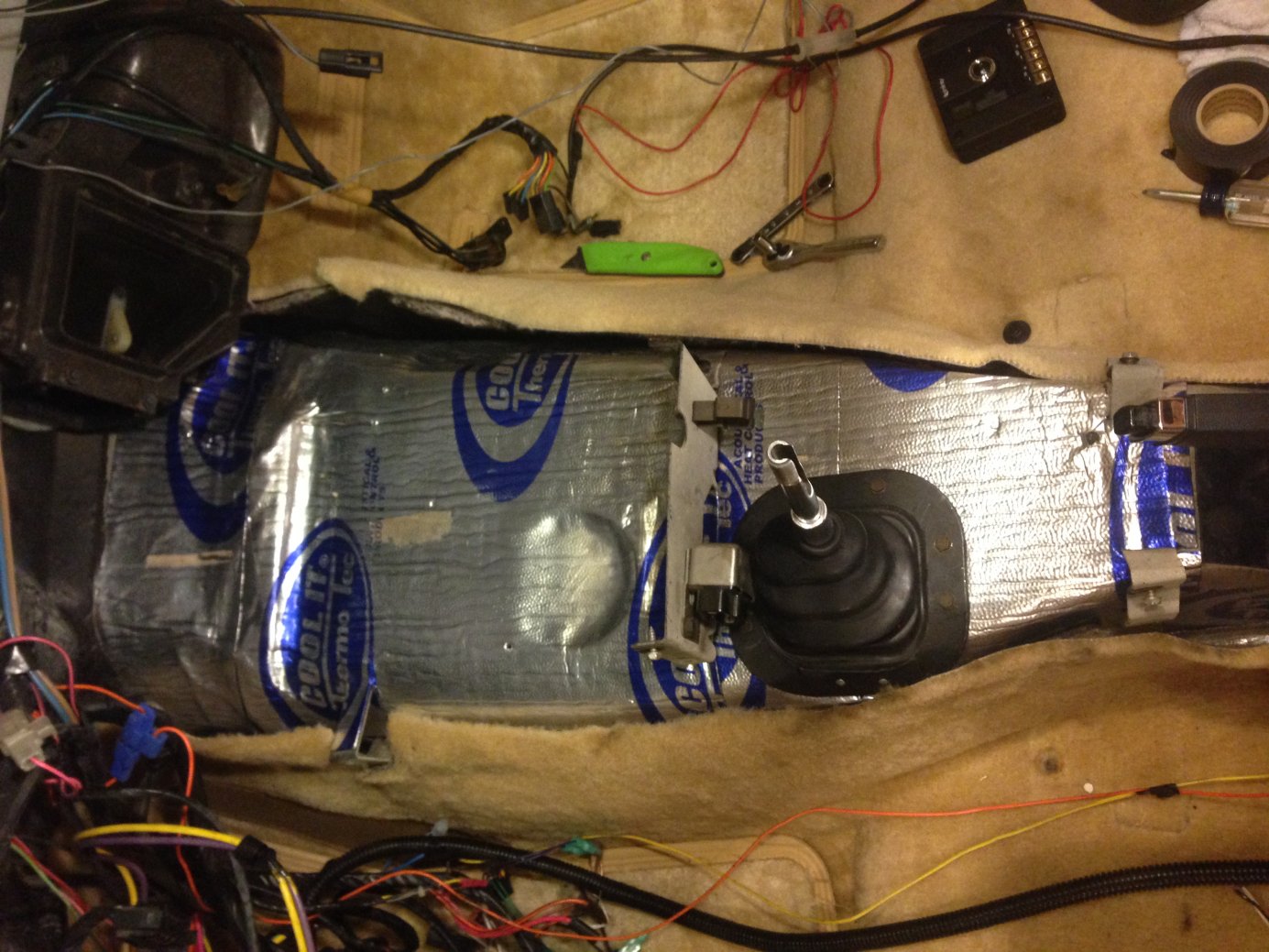

Here is a few pics of the TOP side; still a work in progress.
First pic is how it was purchased, sat in a barn for 17 years from what I can figure.
In one pic you'll notice no door handle opening or key hole. Went with remote opening system. Body was lifted off the frame but not a frame off restore, just a rebuild with modifications.
