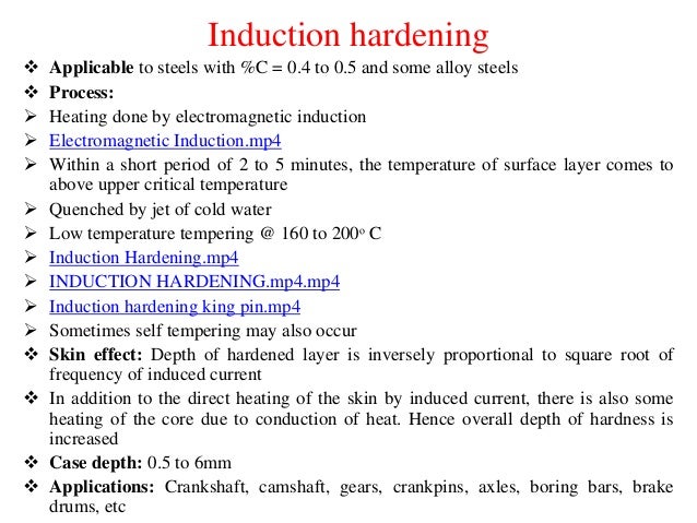

Induction hardened process is heating the base material to about 1200F, then quenched. Although it is an expensive process.
Older seats were flame hardened.
The depth of induction hardening can be from ,5 to 6mm or .02 to .24".
http://image.slidesharecdn.com/heat...eatment-of-steels-ii-29-638.jpg?cb=1447132878
