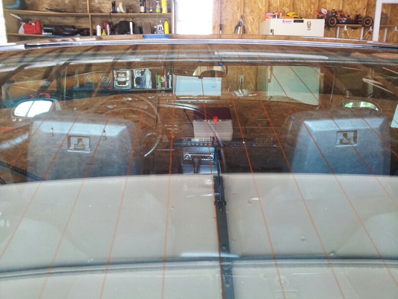

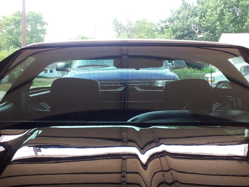

Been searching this one out. But my floor is not dented at all and both my seats lean inward. All the post i see someone missplaced a jack and dented the floor. Mine is seems is just the seat backs leaning. Is there anyway to fix this? Or is it new seat time?

somebody put the seat frames in wrong.
The L & R seat frame or chassis is specific to that side. If you notice the seat has a tilt lever in the lower left front corner...driver side. That won;t work if its on the other side...
The seats have a slight angle to the mounting so they are turned to follow the floor pan.
Its simple enough. Take the 4 nuts off the 4 floor mounting studs and lift the seat & frame out. Or seperate the frame from seat cushions and remove a section at a time. Easiest to remove the lower or bottom cushion then take the floor mounts apart. 4 nuts.
Time to do some housework under there anyway.
Well the tilt lever is on the left side..on the drivers side. But im going to pull them out and check. Something has to be wrong lol
