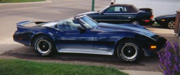

Hi folks, it's been a while since I was last here. I am finally ressurecting my Corvette after far too much time sitting dormant.
My neighbor's kid put a baseball into the windshield last summer but that's OK with me. The car was a rollover when I bought it and the windshield frame never really got aligned properly so now's my big chance. Does anyone know if there's any specs on the windshield or should I just try to align it to the side windows and top?
