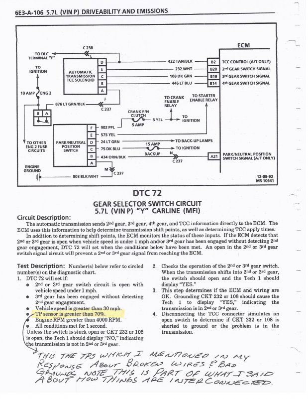

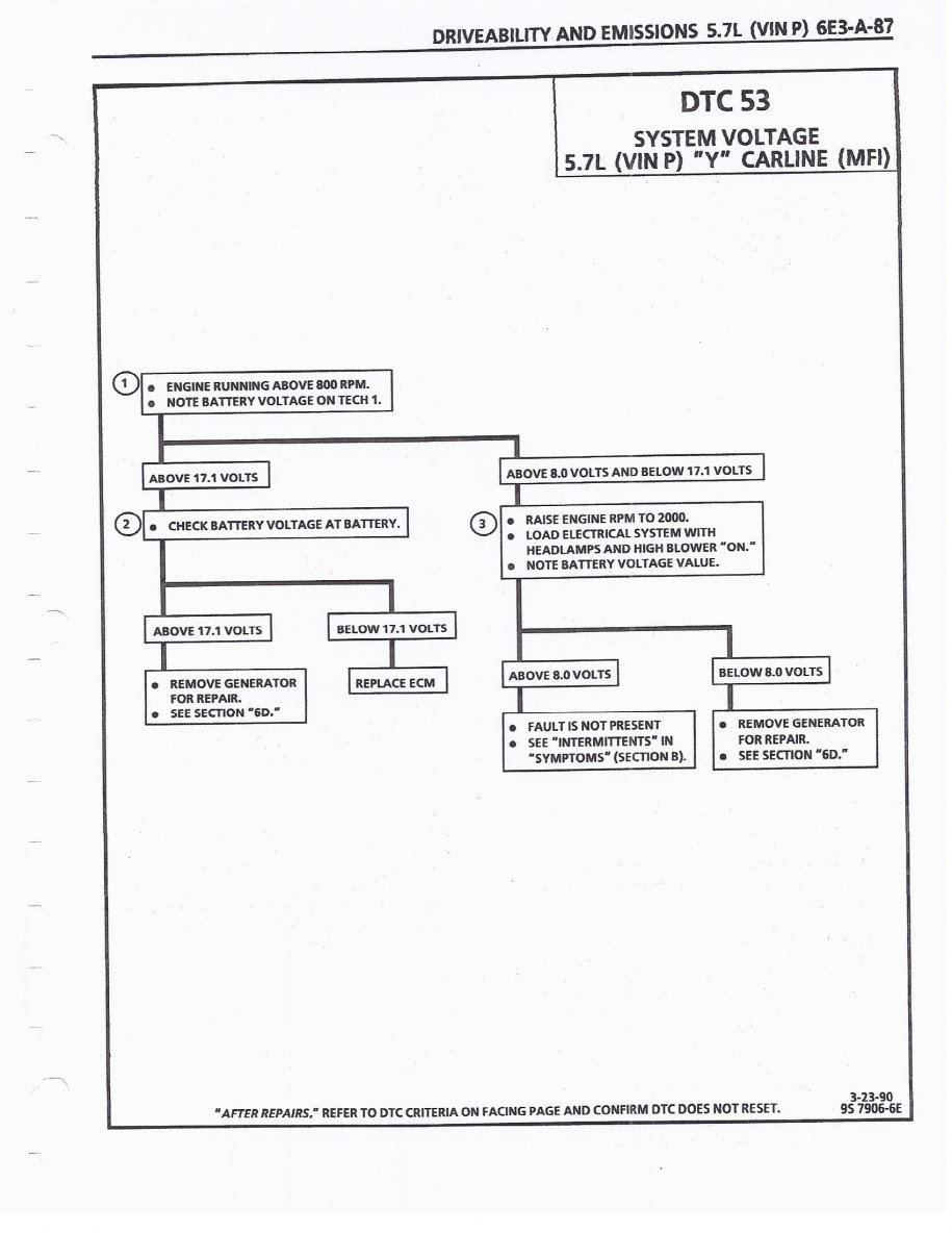

The mataerial I will be sending is from my 93 FSM but I believe it is pertinent toyour 95 as well. My FSM says the code information I have is for cars up through 95 o
Codes 53 & 720001.jpgCodes 53 & 720002.jpgCodes 53 & 720003.jpgCodes 53 & 720004.jpg
Note the items I have highlighted. As I previously said do not let the codes fool you into believing a particular part is to fault. Note how the TPS(Throttle Position Sensor) Can effect the Gear selector switch circuit.
Hope this sheds some light on thetps for you
