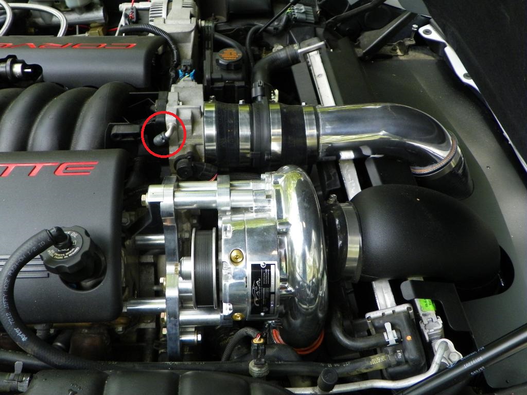

Where does the PVC vent is the question. As it is venting, what the PVC passes has oil vapor in. Mine vented into the TB or the red circle. When I swapped the LS1 intake manifold out it was nasty inside.
The picture is my old setup or one side venting to a catch can. Now, I'm running a Nick Williams TB and FAST and both VCs are vented to catch cans to lower crankcase pressures. Dual PVC is overkill unless you're running some form of forced induction.
Am I just getting old or something, your picture looks to me like your oil cap vent runs directly to your radiator. Tell me I'm wrong.

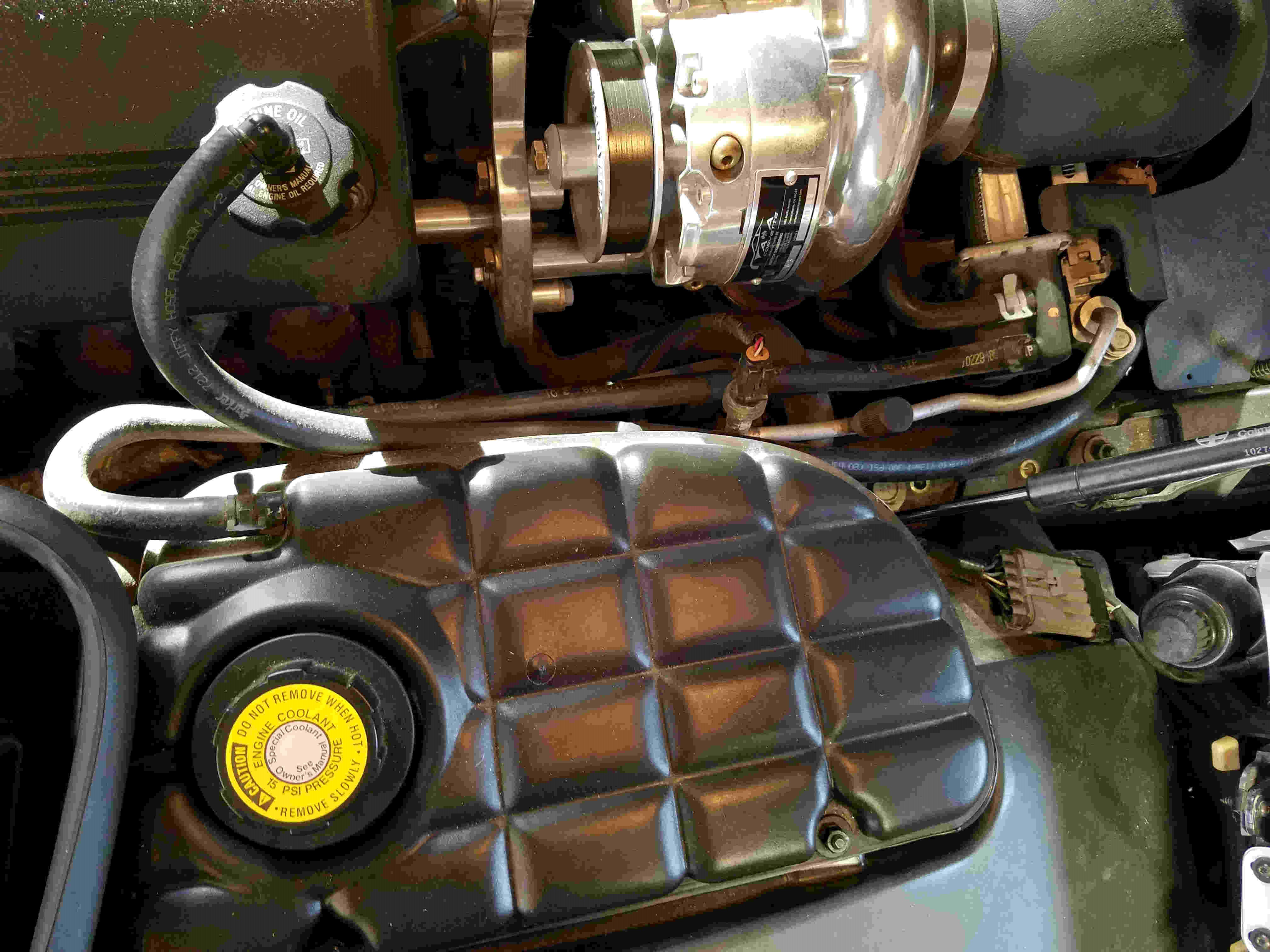

Here's a better angle.. The one goes from the radiator to the expansion tank. The other goes from the oil filler to the can.. I looked at the picture I posted; no I won't tell you that you're getting old; I will say your the first person who noticed..
Good, all is right again. 🙂
LLC5: I never looked at the picture critically.. The other side is easier, but it was a lot harder for me.. ;)
