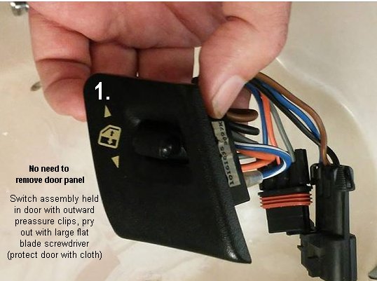

You don't have to take off panel. Gently put small screwdriver or shim on left side of switch push towards switch and then gently pull up.

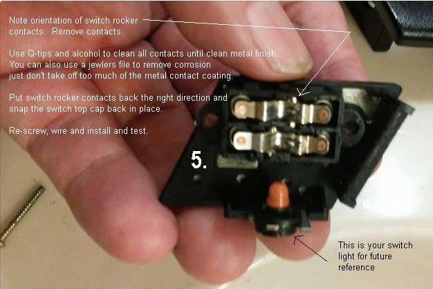

Absolutely, also the switch can be taken apart. Any moisture on the contacts tend to build a film or oxidation which is easily removed. I use a small dremel with a wire brush....makes it good as new and saves a few dollars.

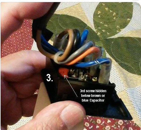

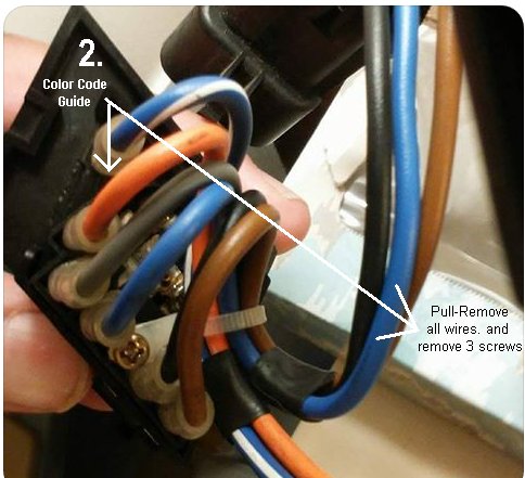

Fix Passenger window switch yourself
This switch, like the drivers side door switch, corrodes with time. Chances are good, these switches can be cleaned up for many more years of service. See images below... as previously said, you DO NOT have to remove the door panel, just gently pry out the switch assembly and pull the two unique wire plugs.
