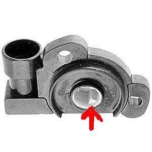

I think what ecss is saying here is that you have to slip the TPS onto the shaft rotated far enough so it engages on the proper side of the tab, then turn it to line up the screws. You may have to have it rotated over 1/4 turn, and be sure you start from the right direction.

That's just it. The proper side of the tab inside the TPS. Is your advice to have the TB plates at the rest position, place the new TPS on the tab in the counterclockwise position and THEN turning it to the clockwise position so it will have tension? Or is it the other way around? That is why Mr. Killebrew had me cut off a little of the pipe, for clearance. You know, I have changed out a zillion aircraft parts on all the big jets and I have never had this much trouble with a part replacement. Of course this time the FSM is next to useless. I'll bet there is a throttle body FSM of it's own out there somewhere.

If you unbolt the IAC housing from the bottom of the throttle body, that will give you all the clearance you need to reinstall the TPS.
It's item #10 the arrow points to the pipe but Item #10 is the IAC/Coolant housing/plate.

Oh, wait, that's WAY too much work. That is starting all over again! Draining fluid, removing the TB, etc. Shoot. I thought you meant remove the IAC. Well, I cut the pipe a little and now there is some clearance to rotate it counterclockwise so I will have to see what happens. If not then I will have to start all over again.
