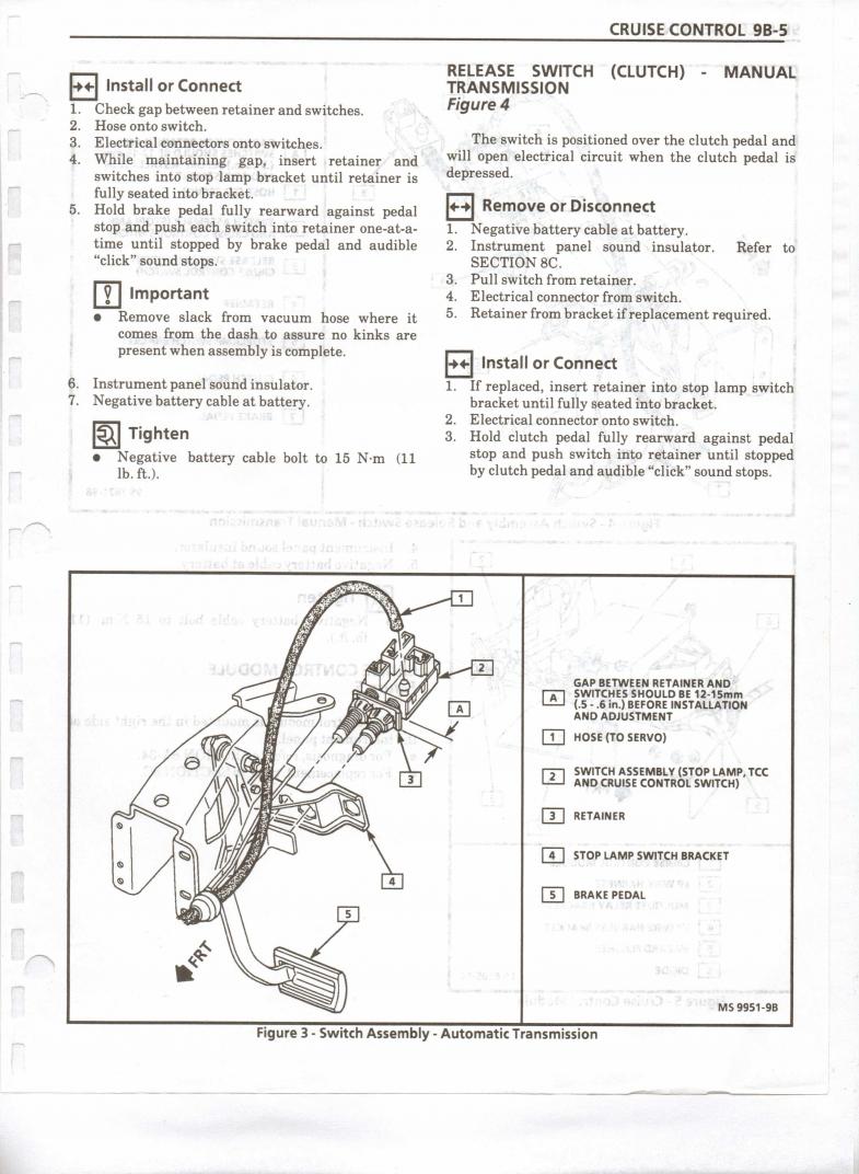

I haven't gotten in there yet but I have no power brakes due to a massive vacuum leak at the pedal. You can hear it - it is substantial. My question is, do you think I can just replace the boot itself or is it more likely the diaphragm in the brake booster is broke around the area the pedal depresses into the booster? I'm not sure how these things are engineered and only guessing. I'm frankly surprised I don't have engine-running problems with the amount of vacuum leak. Was hoping the fix might be more simple than having to replace the whole booster.
