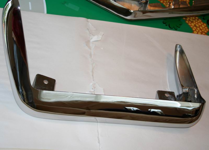

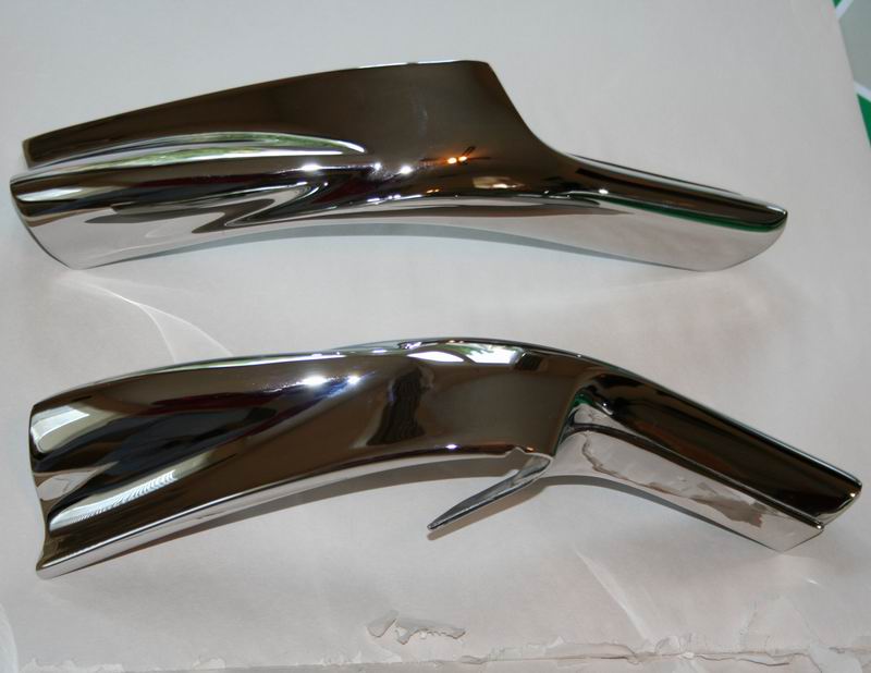

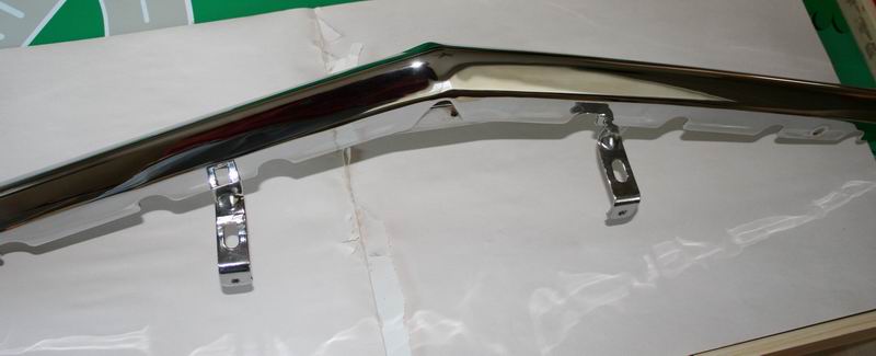

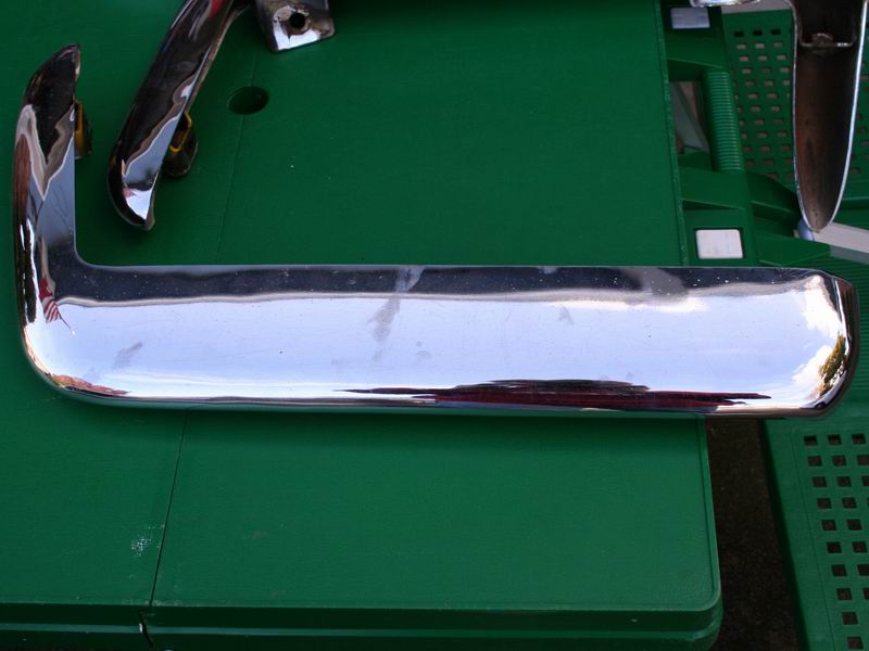

I thought y'all might like to know that I got my parts back today.
The results were absolutely amazing. My only real problem is that once I put these on the car everything else is going to look like crap! :D
I've got a few pictures if y'all are interested:
Before:
And after:
I had a little trouble deciding if I wanted triple-chrome (show chrome) or not but after a little soul searching I decided I did. The only problem is that the NCRS may well consider the bumpers to be "over restored" and dock me points if I ever get judged.
I bought all new bolts from Paragon but I'm probably going to refinish the originals someday. Until then the new ones should be good! ;)
All I have to do now is mask these and paint the backs with clear rust-oleum and then bolt them on.
Hopefully the @^#@$%! rain stops so I can work! :D
BTW, I went with Superior Chrome in San Jose. They do great work and they are 4 miles from my house!
