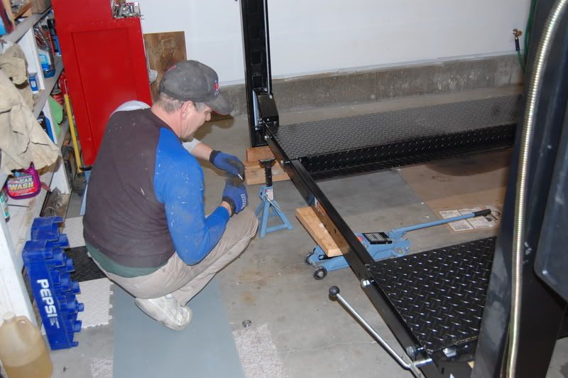

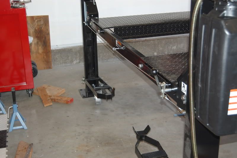

My lift arrived yesterday, and I started to sort out the parts last night. Picking up a few odds and ends and plan to do the assembly over the weekend.
Ray

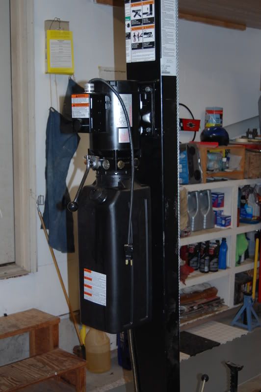

Barrett, my ceiling height is 10'1" to 10'3" (front to door, slope for water to run out). The lift that I bought (Pro-Park 8s) has a little less than the normal overall lift capacity (72" total lift, floor to top of runners). The posts themselves are 83" tall and with the bolts that are used to adjust the cables about 84". I can put the Corvette on the lift and raise it as high as it will go and still have about 2 1/2" clearance (top of Corvette to ceiling). I have to back the Corvette on to the lift in order to raise it all the way up and still open the garage door (I think, as I haven't tried it the other way...it might work that way as well).
As far as walking under the lift, it's no problem with the Corvette up there. But I have used it already to change the oil in 2 of my daughters' cars, a Chevy Venture mini-van and a Mercury Mariner SUV, and I could only get it up about 3- 3 1/2 feet. But it is still better than crawling around on the floor. I haven't tried my pickup yet, but I am sure that the situation will be the same, if not a little lower. The wife's Bonneville should go up pretty high, not to the top but high enough that I won't have to crouch to much.
