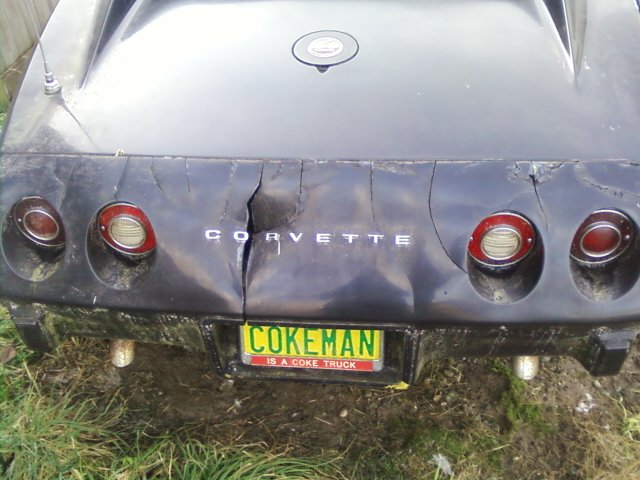

corvette.jpgthe rear fender on my 75 is cracked from all the years sitting in my backyard. mainly from heat/cold because i live in washington and you never know what the weathers going to be like. i was going to see if anyone had any ideas on were i could purchase one of these pieces. and also how much it sould cost. thanks. Ckid

That's called the "rear fascia" or "rear bumper cover", not a fender. The original part was made of urethane, and what you see is typical of how they deteriorated over the years.
Several suppliers reproduce them in fiberglass, which is your only choice for a replacement. ACI is one, and there are others as well; someone will chime in with the names.

Hey thanks for the website! i was looking at the Rear Bumper for the 75 but there is no price? can anyone look at the website and figure out how much it is? thanks. Ckid
The stock rear bumper facia was urethane - not fiberglass. ACI offers a Flexible Rear Bumper facia very similar to the original, and the 1975 versions are available with or without the "corvette" letter indentations. Both versions retail for $399.99. 1-piece fiberglass (hard) rear bumper facias are typically available for about $350. The stock GM rear urethane facias are no longer available from any source that I'm familiar with. You can still get the front GM urethane bumper facias for 1975 - they run about $700.

A friend of mine has a '74 and found his rear cover on the floor in a pile of dust,for no reason whatsoever.....
apparently these bumpers are coming to the end of there life span.....:eyerole:eyerole
The urethane bumper covers first appeared in '73 (front only) and I imagine were never intended to last almost 40 years. I have an original GM piece on the front of mine and it too is sadly coming to the end of it's days. I tiptoe past it and say nice words but the plastic has gotten very brittle and has some cracks showing.
The larger rear covers that appeared first as a two piece in '74 and a one piece in '75 are even more susceptible to hardening and it's pretty rare these days to see one still intact.
Allowing the car to sit probably extended the life somewhat, but the inevitable has arrived. ;)
