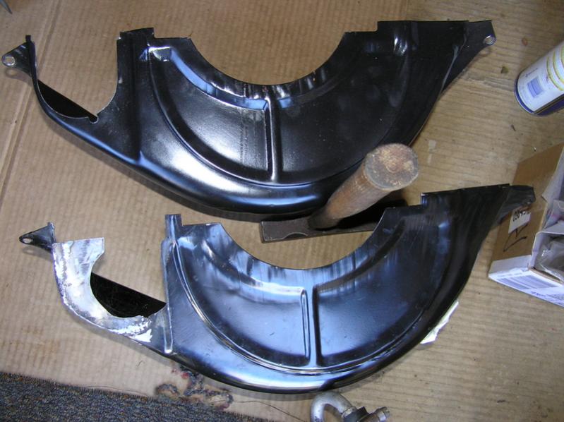

I've decided to keep it simple and use then my "orig" starter on my ZZ4 motor. I was thinking of getting one of the :thumb fancy gear reduction starters but decided I could put the $200+ to other stuff I need.
Regards, Fred
