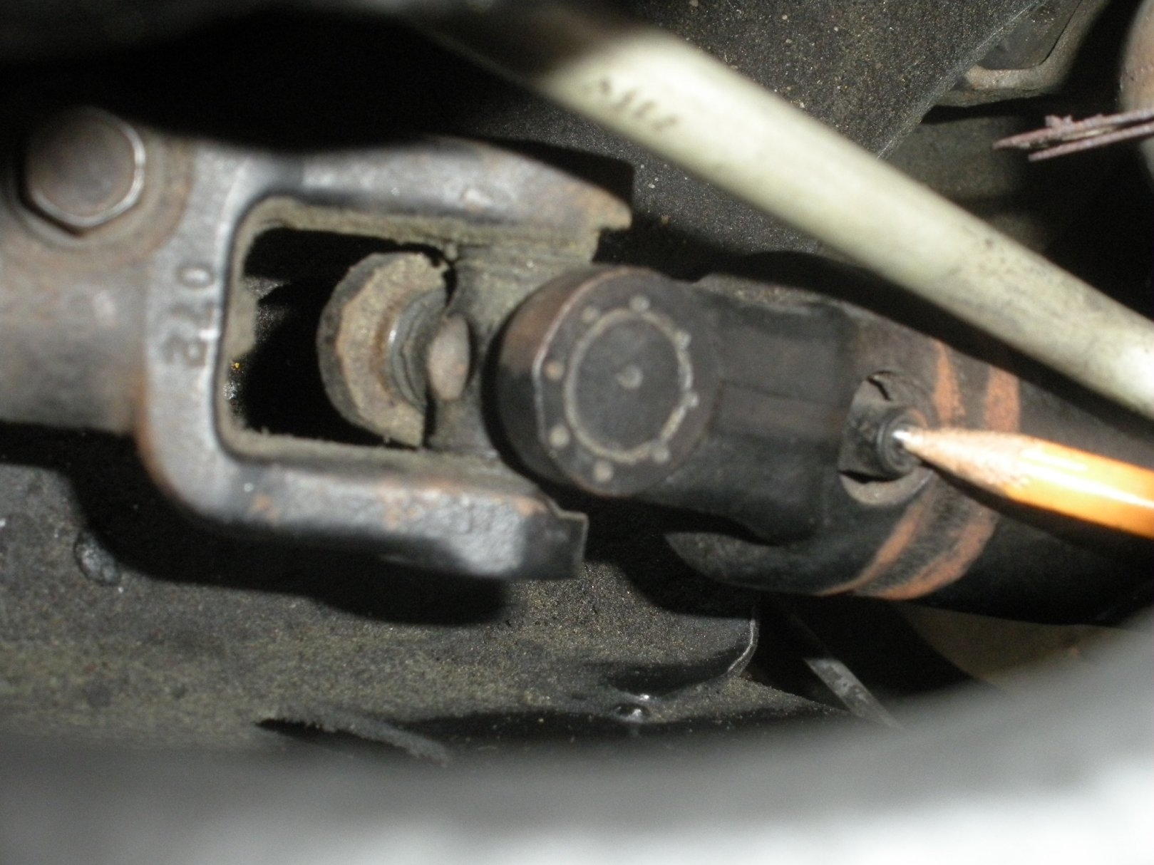

I might not understand your "steering slips" description, but here's a possibility. If the steering wheel occasionally takes a new position, about an eighth of a turn from the original position, it might be the vibration isolator, that's located in the intermediate steering coupler. Just above the u-joint that attaches to the steering rack, look for the anti-rotation safety pin, shown in my photo. If the rubber sleeve in the vibration isolator is broken, this pin will be off-center. As you drive, this pin will shift from one side of the hole to the other side, which gives you the new steering wheel position.
