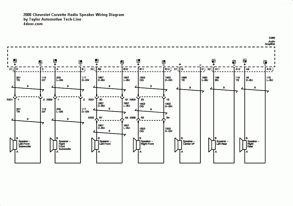

The base stereo system in the C6 is disappointing to say the least. Today I installed JBL GTO rear and upper door speakers. The woofers remain stock. The re sult was very pleasing. The biggest problem was finding a wiring diagram. 2008_Corvette_Wiring_Radio_Speaker_Diagram.gif Here it is if anybody needs it.
Good find - thanks
