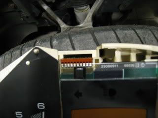

The instrument was working fine in the beginning, but the digital one started to flash soon after i got the car. Only a part of the digital instrument was working for a while when i had the vette outside. I have the vette parked outside the garage were i work. After working hour i drive the vette inside the garage for safekeeping and repair. Once inside the digital instrument usualy got better after a while in warmer temperature. It went blank once, but a few days later it came back. After 2 weeks it went blank again. And stayed that way ever since. I took of the cluster panel and repaired som bad contact on the stick to the panel and the stick to the digital bit. But it still doesn't work. The vette has a cracked window. It has been since 96. Don't think the water get's pass the crack, but there are a small water leak between the sidewindow gasket on either side. There are a lot of rust in the coupe :eyerole inside the dashboard. I don't think there are something missing on the instrument, but perhaps i should measure the ground to the instrument. Anyone know's witch wire that leads to ground and what value i should read on the different pins on the digital stick? I've just ordered a service manual book. Until that arrive, i'm shooting in the blind :confused
