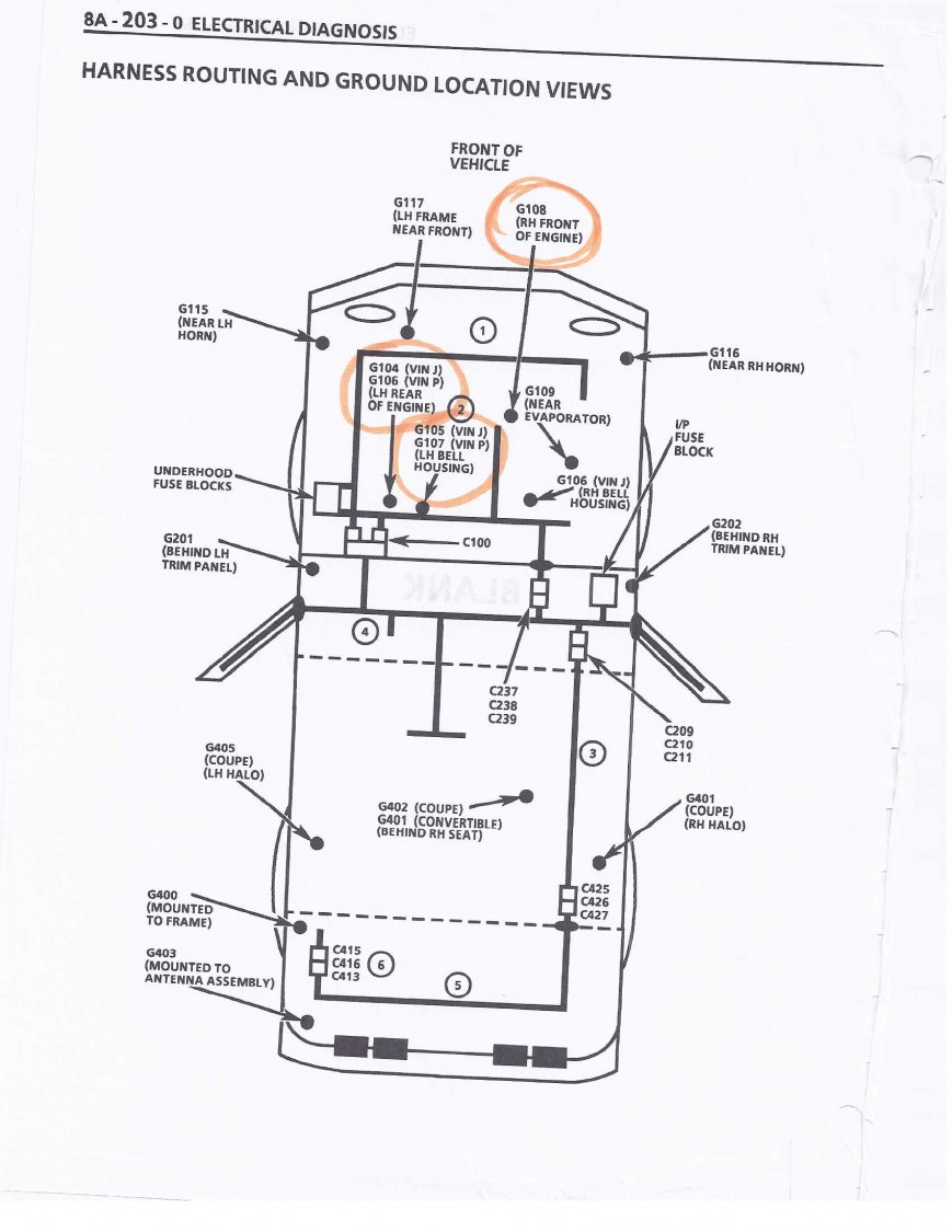

That's interesting. I was reading a book written by a Chuck Probst on the engine control fundamentals of the corvette. My printer scanner is down so I am going to type a small section of what he says. about Limp Home When the computer, itself is not operating normally engine management changes to Fuel Backup, or "limp home" mode. This could be under any of the following circumstances: A computer voltage less than 9 volts A cranking voltage less than 9 volts Missing or nonfunctioning Programmable Read -Only Memory (Prom) If the computer fails to issue Computer Operation Pulses (COP) When one of these situations occurs, the computer runs on something called the Cal-Pak chip, operating the engine only on inputs from a few sensors: Manifold Absolute Pressure, Throttle Position, Engine Coolant Temperature, and rpm . In another section he talks about battery voltage If the battery voltage falls too low, slower fuel pump speeds may reduce the fuel delivery to the injectors. The computer increases the injector pulse time to compensate, and can raise the idle rpm to increase generator output. Electric ignition in the LS! and ZR! can increase dwell time, So it may be that you have bad grounds land am losing voltage to the ECM Cleaning all the grounds may solve your problem.
Thanks for the diagram .. Gives me something else to check. I'll keep you posted,,
Grounds all look good. Actually for the mileage and age this car is very clean under the hood. Problems point to trouble with the optispark so I will be changing it out as soon as I get a replacement. Should be here by Thursday I'll update after it is installed. Thanks for the replies...
