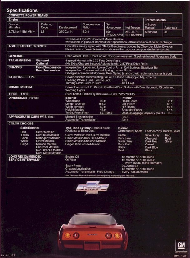

I don't know the figures, but to validate production of Two Tone 1981's I offer these two pages from 1981 Spec's and Magazine Cover ;)
As stated Bowling Green Built 1981 Corvette had the option of Two Tone paint scheme... It has been rumored that a few as many as 12 - 14 were produced at St. Louis prior to production at Bowling Green. These were the new Base Coat Clear Coat, while all the other production St. Louis built Corvettes were Lacquer Solid Color Paint schemes...
