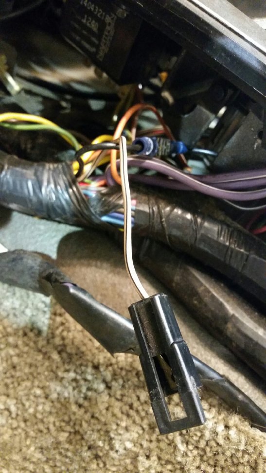

Located in the console, near the rear defogger, blower motor switch (Driver side). It is pink with a black stripe.
1982 Collector Edition;
I can't find anything to plug it in to.View attachment 22230
If memory serves me correctly (50/50 chance) pink/blk stripe is an ignition feed. As stated in the previous post it is most likely an accessory not installed on your vehicle.
As LLC5 said, pink/blk is an ignition feed. (Small guages if I recall correctly) only thing in that area that would use this wire is the rear window defogger switch.
I did notice that the wire in the pic doesn't look very pink though. Looks more like tan. (Could just be the pic though) if it is tan/blk it may be a diagnostic terminal for the egr (from memory). I'll check a few diagrams later on today and confirm
The wire is def pink w/black stripe. I guess the pic doesn't show up that well.

Any idea on what accessory that might be?
My best guess is what Antz81 suggested, possibly a rear defogger switch, with a further possibility of export option.
It is for the rear defroster,If you don't have one.
as least on my '81,I would imagine its the same for '82
:thumb
I have the identical extra lead on my '82 and have often wondered what it was. Mine is indeed tan and I thought it was related to the anti-theft system. My horn does not honk when the system is activated, so I thought it might be related to that. (any ideas on getting the horn to sound out as such?). My bone-stock car has all of the electrical-related options that were available in '82. Seems odd they would put an EGR diagnostic lead in such a hard to reach place when it was already fully designed with self-test capability - but, I've seen stranger things happen with this wonderful hobby car.
