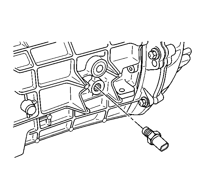

Hey all. I've tried a number of times to get some fairly simple info on this forum. Multiple views but no replies. Just a simple question....."see reverse switch location post" Been a member here for years and been to Cruise Fest too. Did I piss someone off?

On the right side (passenger) of the transmission!:thumb

Is this something that commonly goes bad? I noticed that the rear back up lights don't come on also. Thank you.

;shrugI've only had to change a couple of them on C5's,But I have only had to clean the connections on the plug of a few that made them work!:thumb It's the same set up and switch on the C6.:thumb:thumb
