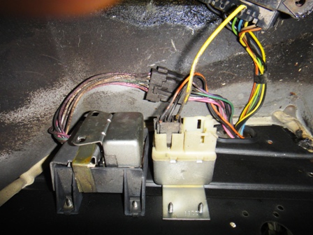

OK guys , here is the first of many questions now that I've gutted the interior for restoration...in the storage well behind the pass. seat , I dont know if you can tell but the thick yellow wire coming off the bulkhead is not connected :confused any ideas where it goes and what it's for ?? Thanks ,

Antenna?
Hmmm , antenna is working fine with radio, guess PO ,re-bubba'ed the hookup..I was wondering why everything worked and I had this wire just sittin there ..
qusetion is do I leave it or open up a can of worms and try to figure out what he did..:ugh

The thing that is not connected to the wall and hanging loose is the famoes alarm system. :)
Sorry forgot about the other ones but in your wiring diagrams you can look it up very easily.

Believe it or not, that crazy alarm system still works on mine :D Now... the power door locks..... that's another matter. hahaha

Thanks guys , antenna is ok ,so I'm thinkin alarm is it ...not a problem .
