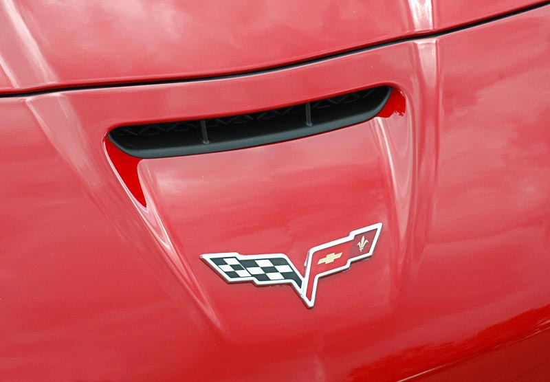

Is the front opening on the C6 Z06, there is what looks like an air intake, see photo.<br><br>I've been told that Z06 engine air does not really enter there, it is just a styling "feature"?
True?

Yep. A styling geegaw.
I've been wondering how to make it functional.
I just looked at mine. I thought it was functional. Nope. It's blocked off. That's the one thing I don't like. Reminds me of the plastic hood louvers on my previous car. A styling measure that just collects a lot of dirt and makes take longer to clean the car. If there's no function for it, keep it off the car, imo.

I have to revise what I said earlier in the thread about my front opening. I just shined a flashlight into it and was able to see triangular shaped lights reflecting on the air intake. It appears it is open. And the way the air intake is shaped, any water that does come in will go around the intake air cleaner and down and out of the car. So it is, indeed, functional. At first I thought it was blocked off. But, now I can see how it's set up. I guess it slightly pressurizes the air around the air cleaner at highway speeds. But, doesn't let in so much as to allow water to overwhelm the shedding ability of the moulded air cleaner.
I also found a warning in the owner manual that directly spraying water into that opening could cause water to get into the engine. So care is needed when spraying water on the nose during cleaning.

I also did the same thing a couple years ago with a flashlight and peaked under the front of the car and yes I can see some light entering from the front opening. So if you can see some light then some air is getting to
the air cleaner. It may be just a little but it at least is getting some !! :thumb
