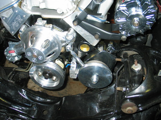

I've had nothing but problems since I bought them, they look GREAT but they don't fit. I installed the PS bracket and it fit great ( more on this in a minute) I also installed the alternator bracket, to bad the belts don't fit with each of these on.

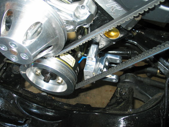

They look great on the motor, don't try to place a belt on this.
Back to the Stock Bracket, no way to make the Zoops play together
Pulleys don't line up, block for mount is in the way on the PS pump
Ignore the belt placement, sawsalls are my friends :L, cut the end off the Zoops PS mount so I could clear the belt for the alternator
Finally got everything lined up, not easy but expensive........had to modify the Zoops PS mount stuff, move the pump backwards. The instructions said that you need a triple pulley system...........BS, I'm using 2 it it kills me ;)

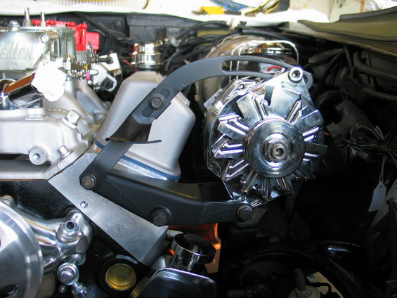

Now have to measure the belts and get everything connected. This was a pain in the you know where. Funny I was "told" that Zoops would fit an 81 vette..........the alternator bracket(s) that I bought put the alternator about 2" above the air cleaner.............back to stock. Jesus I'm tired of 16 year olds telling me what will and won't fit, just to find out myself that it DOESN'T fit

I actualy bought BOTH Zoops mounts for the alternator and neither of them work........stock works just fine, sand paper and some paint does wonders.
I wanted a cleaner look, hence the Zoops stuff but the fact that the alternator sat higher than the air cleaner went against everything. I have an Edelbrock RPM Air Gap intake, it won't fir under the stock hood, so when the alternator was higher than the air cleaner, I decided enough was enough. I'm already buying a new hood and had no idea how much higher I wanted or could go before I ran into problems with hood clearance again.
