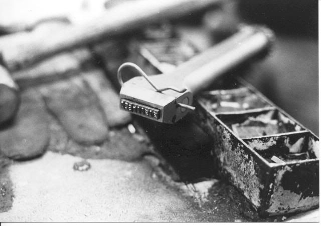

The original engine and transmission have VIN derivitives stamped on them. The assembly instruction manual will show the locations. Engine and transmission were stamped with the same tool by the same worker on the assembly line before the engine and trans were installed in the frame.
