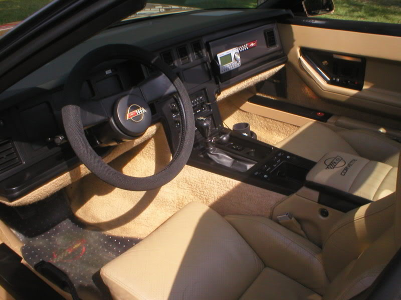

On my 84 the switch is located on the consoule next to my drivers window switch. Whats wrong with yours? vette-05.jpg
On my 84 the switch is located on the consoule next to my drivers window switch. Whats wrong with yours?View attachment 12822
Doug,
Wow super clean 84' you have . . .
I have no power to my overdrive, the overdrive light does 'not' come on, nor is there overdrive in 2-4th. I replaced the overdrive relay, on the firewall, there's (2) relays there, one for the fuel pump (I did not replace) then the overdrive (replaced) is the one closest to the valve cover (is that correct)?
Still no overdrive light on the dash nor no overdrive in 2-4th.
I've taken a look at overdrive "switch", located on the console next to the 4sp shifter - it looked real clean (have 34K miles on the car), but for the life of me, I was unable to determine how to remove or test the overdrive "Switch" - any thoughts here?
