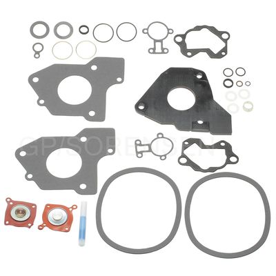

Tb model numbers
Where can i find the tb model numbers to order a gasket kit? Or does anyone know the kit numbers
GP Sorensen
Part #: 96-629
