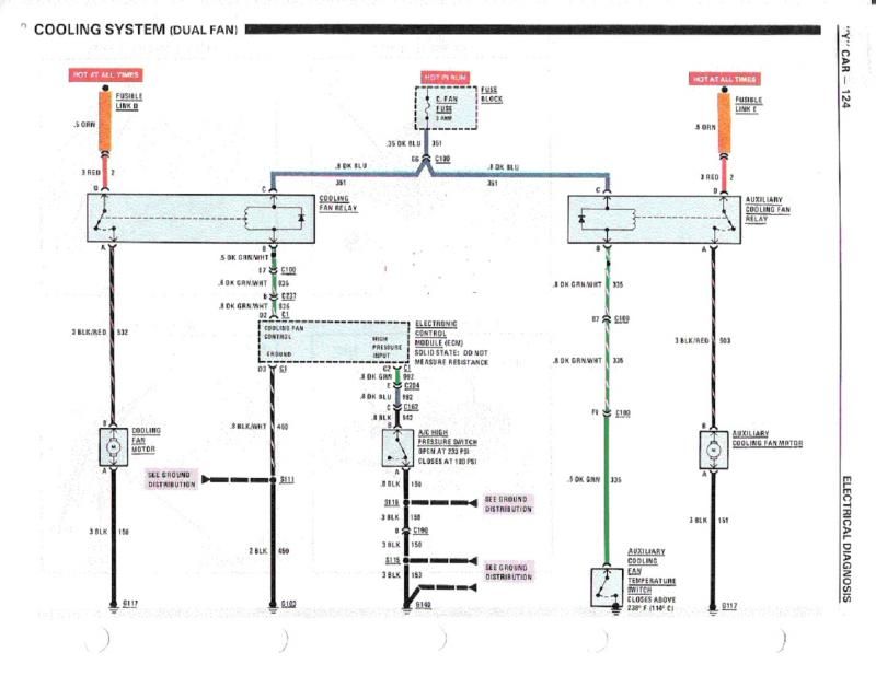

I have a question regarding the electric cooling fan on my '85 Corvette. I thought I'd ask in this forum first. My fan has always come on at 204 degrees and shut off at 196 degrees since I've owned it (2001). Now, for some reason it will come on at 204 degrees and it might just keep running or it might shut off at 180 degrees. Just today, when I started it at "LO" temperature after it sat all day, the fan came on. I turned the ignition on and off twice and it went off. I suspect that it's the sensor located on the right side of the engine block just behind the OIL dipstick, but I don't know for sure. If I let the fan continue to run all the time, will the fan motor me able to handle the load or will it burn out from over use? I don't know what quality these fan motors are.
