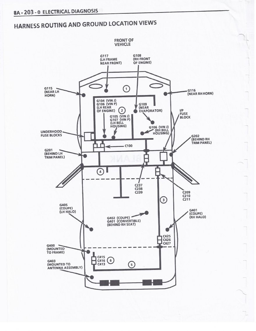

I have a 1992 corvette base coupe and a couple of days ago while I was driving it The check engine light came on, the service ASR light came on, The speedo quit working, the AC went hot, and the security light on the left of the instrument cluster began to blink. I turned the car off and then back on and problem was gone. It has happened a couple of times since then. It seems that after it sits for a while it resets. Any ideas? Anyone else had this same set of circumstances and know what I should do to fix the issue? Thanks for any help guys. It is my first corvette at 42 year old and I love it. I sure hope there is a simple fix.
