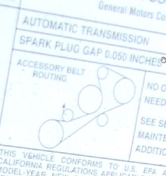

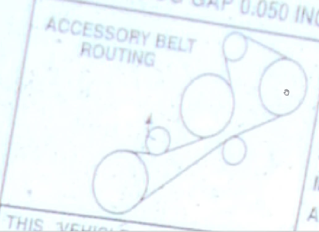

What is the last pulley I should be putting the belt on? The alternator has ribs - so it is hard to get over the flange.
How can you see markings on the tensioner - it is down under the water pump?
This is the belt route label under hood
attachment.php
Some people mention it's a piece of cake and some mention the belt recommended is to short.
Some people say let the belt sit in the sun some have said put it in the clothes dryer. :rotfl
Might take two people one pulling on the tensioner and if you can get the belt started on the alternator pulley, use a open end wrench or socket on the alternator pulley and see if you can rotate the pulley and roll the belt in place.
If you can't get the belt on put the original back on or get a belt .25 inch larger.
Goodyear 4060672.
You're not the only person who has mentioned this problem so it must be a GM tolerance thing. :chuckle
Belt
