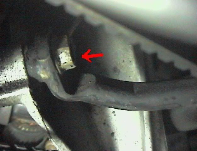

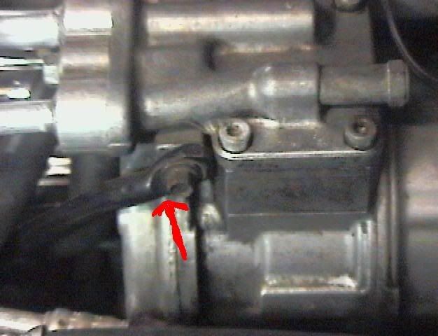

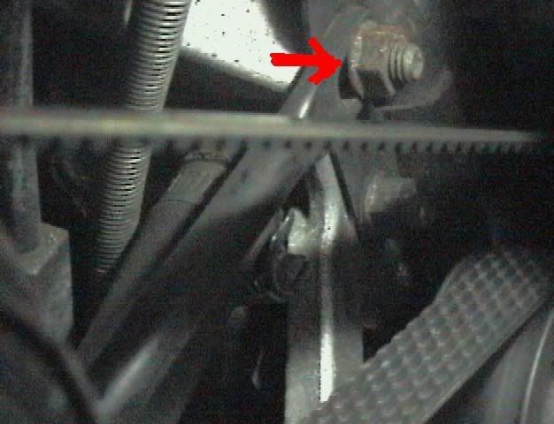

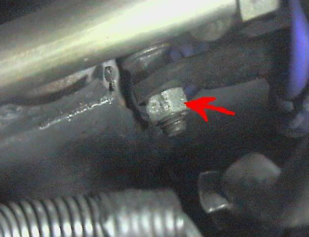

Here's some pics.
One brace goes from the top left compressor bolt to a stud on the exhaust manifold.
Top left bolt on compressor to bracket bolt
Other end bolts to stud on exhaust manifold.
The other brace goes from the right side bottom bolt, (attaches to the back side of the bolt) to top stud on the water pump.
Back side compressor bolt
Brace end at top stud on water pump.
